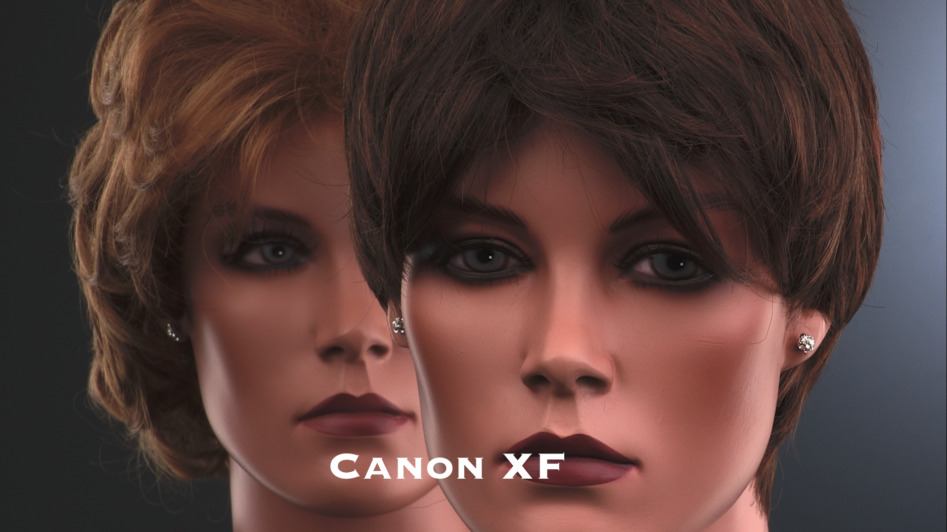

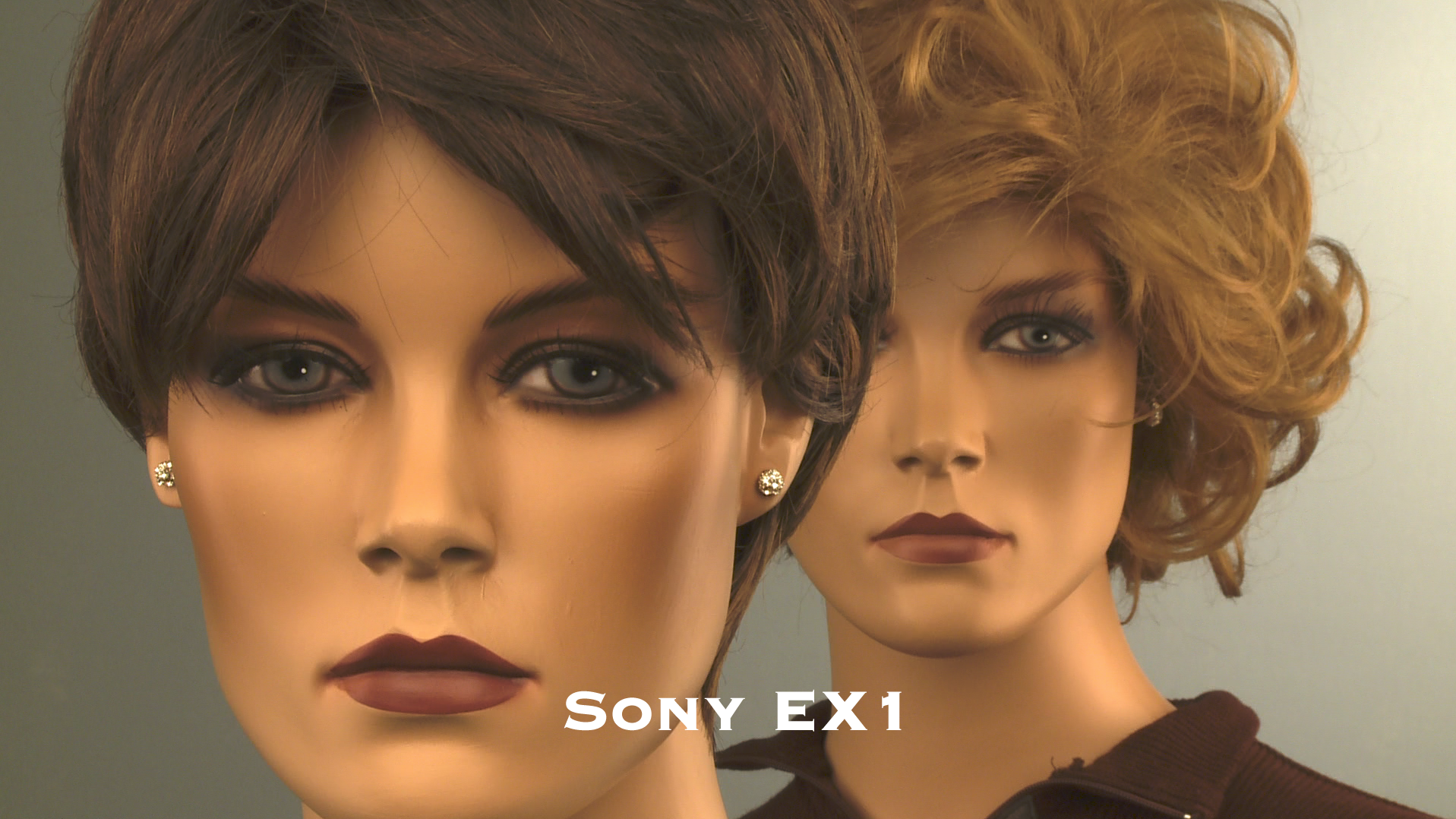

How come the Sony EX clips lack pink skin tones?
I remember noticing how the Sony clips from my TRV-900 lacked the pink of human skin tones when I moved off my Sony TRV-900 to a Canon XL1s but I chalked it up to moving to a better camera. Is this just a PP setting or what?
Raw samples of Canon XF300 & Sony EX1R-sony-skin.png   Raw samples of Canon XF300 & Sony EX1R-canon-skin.png

Am I missing the point?
Is it just my imagination, or are these CGI images? They look a lot like a rendering I saw for a Lightwave 3D how-to book a few years ago.

Well, it's just your imagination. These are frames from actual footage recorded on those camcorders.

There is a big difference in the lighting, white balance and exposure between the two shots which doesn't help making an accurate assessment. But Sony cameras do tend to have a lot of yellow in them. At the same time Canon's cameras tend to have a little too much red (giving a pink hue to clouds etc). It's easy enough to adjust these out in the Matrix of either camera however.
Sony have always tried to make all their cameras have similar colorimetry from todays latest cameras to early tube cameras and I think this is where the yellow bias comes from. It may also be a bias that favours Asian skin tones.
When I used to have a Canon H1 I used to run with a CP with some -R in the matrix for a more neutral look. With the EX1R I use various PP's for different jobs, but they almost always start off from something like this:
R-G +6, R-B +10, G-R -6, G-B -8, B-R -15, B-G -10

Those pictures have zero value. I'm surprised Chris hasn't just removed them.

Haha, those are definately CGI based images. Les, I don't know where you acquired those images but they are certainly not from a video camera. Alister's comments would have been a good analysis if they were in fact real. haha. In point of fact, the CGI photo attributed as the Sony based image has more in common with the idiosyncrasies of Panasonic based output than Sony.
Any discussion on this is completely ridiculous. If it was a Sony camera, as Alister has pointed out obviously it wasn't white balanced. Sony cameras never pushes out this kind of yellow skin on a properly balanced camera or even one that is off and set for daylight but shooting under tungsten. It's just preposterous. haha.

The stills I posted are screen grabs from the clips that are the substance of this thread And were posted in the beginning. . I believe they are from the zip files. I'm not saying they aren't CG just saying where I got them from

The reason they look odd is that they are I believe mannequins not real models.

mannequins
Now that I have downloaded and examined the video file, it is obvious that they are mannequins. No CGI involved.

I realize they are mannequins. I use mannequins sometimes as alternatives for stand-in's. It's not the subjects, it's the conclusions that could be drawn from watching the subjects that would be false.
This side-by-side simply does not accurately reflect the differences in capabilities of both cameras.
