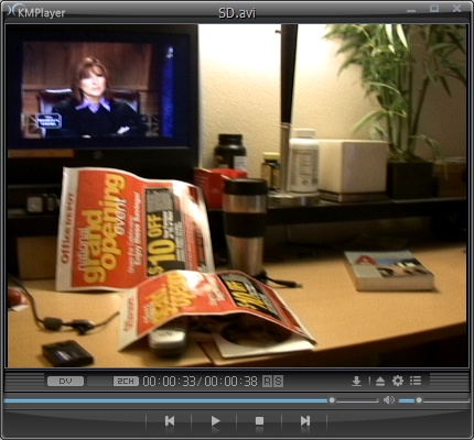

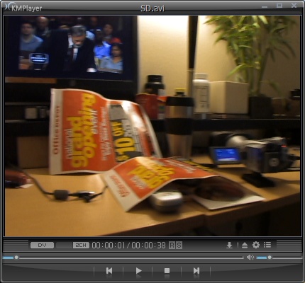

I have been shooting using both Canon XH-A1 and HV20. It takes a while for me to learn to match the color tone from footage of these 2 cameras.
I am using the Matrox RTX2 card that has such feature to match color from two clips by referencing the shadow/highlight/midtone area of two clips. It works very well. I also printed a Black/White/Grey card using photoshop. Then I will shoot a few seconds of that card in the location by both cameras. In post, I can just match them easiliy. I heard there is a a similar feature in Premiere but I didn't bother to find out.
Recently, I tried using XH-A1 custom preset #13 "OUTSIDEN" in XH-A1 that can closely match with HV20 setting color -1, brightness +1, contrast -1. It's not a 100% match but is pretty close.
If you guys have any experience in matching the color of HV20 and XH-A1, please share.

I just tried it on HV20 cinemood compared to A1 preset #8. They aren't quite match. Is HV30 has a new cine mode that will match better?

Maybe it means XL-H1 not XH-A1. I just tried HV20 Cine mode + XH-A1 preset #8. Not a match :( Still custom preset #13 download form here is the cloest.
