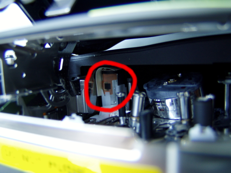

Don't use cleaning tape if not necessary. First you should clean only erasing head, when you see drop-outs.

There are no erase heads on DV or HDV cameras Atrur.
Old June 14th, 2009, 11:57 AM   #10
Location: Poland
Posts: 24
Hmm, what is it?

Old June 14th, 2009, 12:24 PM   #11
Join Date: Mar 2003
Posts: 4,711
You can tell there's no erase head ahead of the record / play head by doing this: record 15 seconds of footage, rewind 7 seconds back and record something else.
Inch the tape forward or backward frame by frame to find the scene change. You'll notice that partway through a frame it changes, proving that the record head is doing the erasing.
In VHS days there was always a half second of noise if you did this test, because the stationary erase head was inches away from the spinning head drum.
tom.
Old June 14th, 2009, 12:42 PM   #12
Location: Poland
Posts: 24
OK, there's no reason to not believe you but tell me what this part is?
Good cam :-), poor english :-(
Artur Smiech is offline   Reply With Quote
