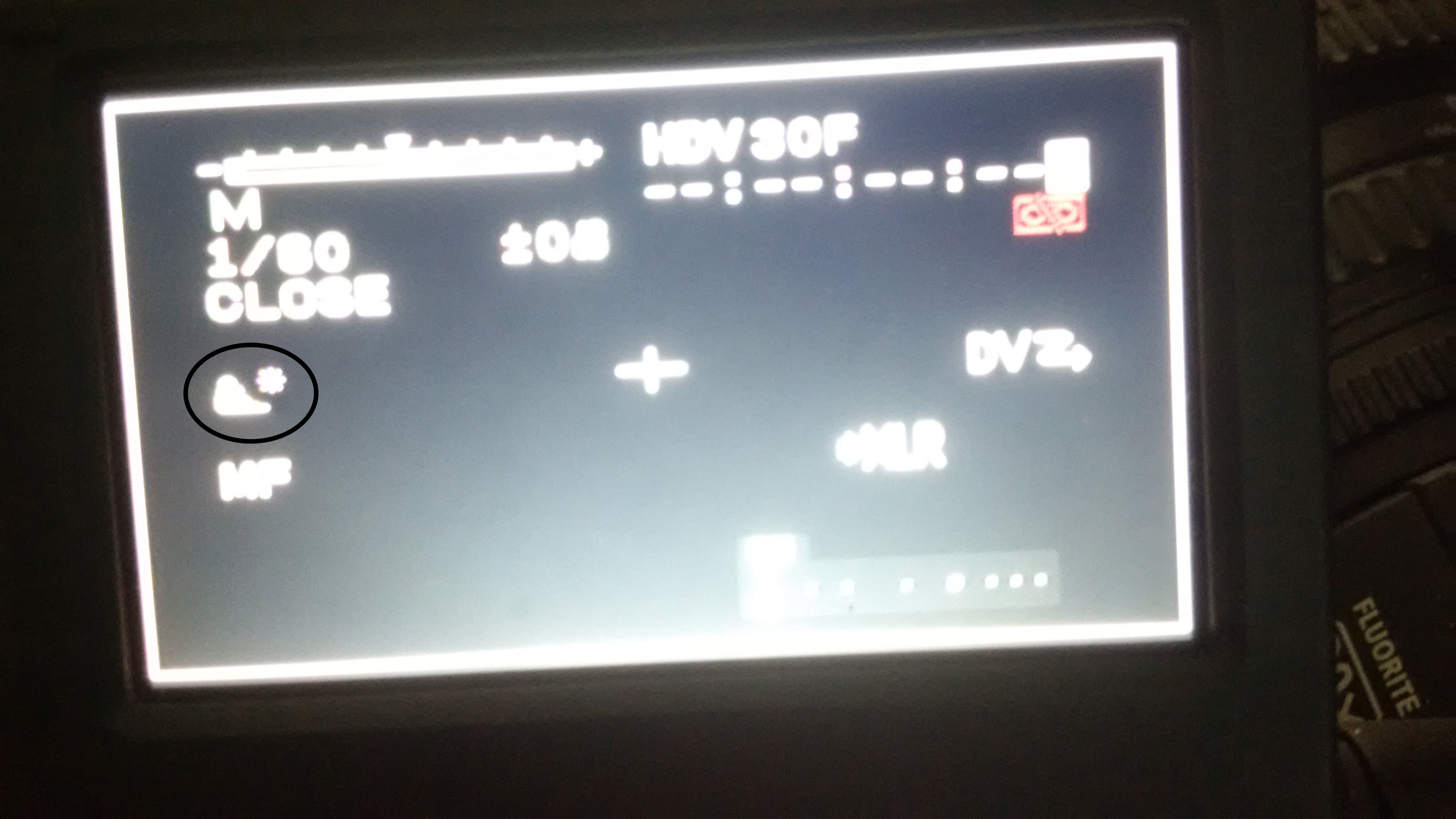

Dusted off my XH A1 that I haven’t used in almost 8 years. Was getting re-acquainted with it. Can’t figure out the cloud and sunshine pictogram on the display and where the switch/button/wheel is to effect change. Didn’t find anything in the manual about it. (Doesn't mean it's not there, just didn't find it) Anyone out there remembers ? Cheers !

Welcome Francois. Did you load any custom presets 8yrs ago? Given your A1 operates Ok, not sure but try setting the white balance on a white card, page 62 in this manual …

Hi Allen. Thank you for the reply. Went through all the motions. I had set the white balance, even tried preset (pic was taken on the preset setting.) That is why the picto for the WB is not there. Tried it with and without the custom presets (even removed the SD card) If ever you have any other ideas, I will be more than happy to entertain them. Again, thank you for your time ! Cheers !

Hi Francois, if you haven’t already done this, after 8yrs. like your first initial set-up, the internal Lithium battery has to be charged for 8hrs, obviously connected to the wall power while doing this.
Then I’d shoot test video in all the picture settings, this might clear that cloud/sun reading. But first make sure the tape tpt is Ok, after 8yrs make sure the rubber tape pinch roller hasn’t disintegrated, first fast fwd. and rewind an earlier prerecorded tape, then play it. If it makes any audible squealing sounds, stop immediately. Then run a new cleaner tape for 10secs, and try the recorded tape again. If no go, get a quote for repairs. I think the XH A1 is still supported by Canon.

Francois try this: menu > camera set up > sky detail > OFF.

Hi Allan. BINGO ! Right on the mark ! You're a star ! Would have been easier if Canon had included a picto in the manual on page 68 ;-) As a foot note, I don't use the tape recording on the camera. I have a Sony HVRA-CR1 Memory Recording Unit hooked up to the Firewire port. (CF card) If someone else reads this and want to use this camera, it's the way to go. Way more reliable than tape. It's surprising how this camera has withstood the test of time. Picture quality is way up there. Again, thanks a million ! Cheers !
