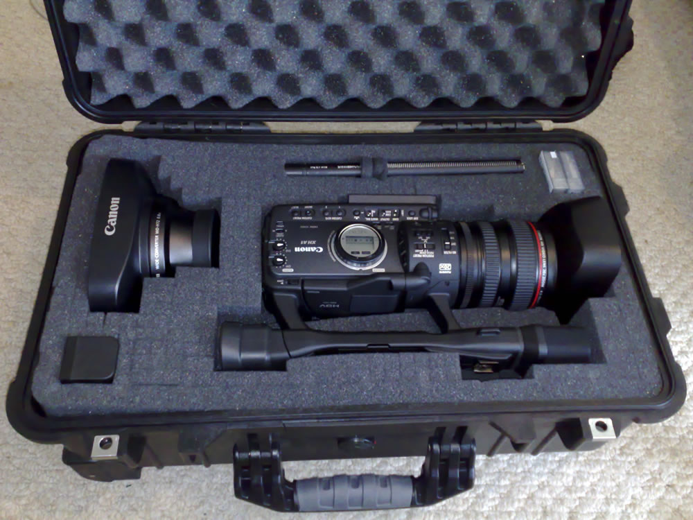

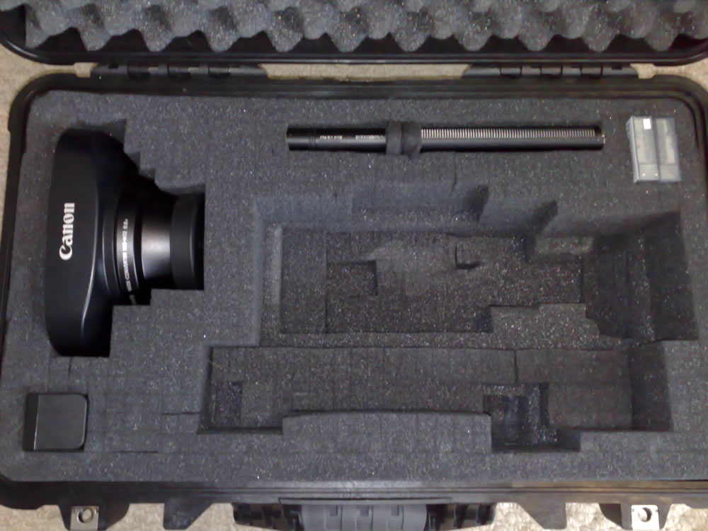

Hi there.
If you have the pick 'n' pluck foam with your peli case then the amount of cutting you need to do is minimal. I've attached a couple of pic of my Peli 1510 showing how my A1 and accessories fit inside it. The foam in mine came in two layers, it's just a case of removing what you need from both layers.
I removed the top layer first by roughly marking around my camera by easing the pre-cut parts apart and then removed the camera shape. After that I did the same with the bottom layer which was a slightly different shape as not all camera parts made contact.
I wanted to be able to leave the matte box thingy attached so have also cut some of the foam in the lid which allows me to close the case without putting too much pressure on it, but at the same time keeping everything snug.
Some of the bottom layer parts can be cut in half with a bread knife (or other serrated knife) and reinserted to give a shallower base.
I've yet to glue all the parts back together in mine as I'm not entirely sure what glue to use, but it works well.
Paul.
