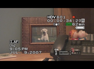

Well I figured out how to burn in character's on the tape, only problem is I need only the time and date, and it seems that everything that shows up in the viewfinder (applications/settings) are also burning to tape. I know you can customize what displays, but is it possible to clear everything except time and date?
Here is the image I am getting:

Posts: 27,382
Yes it is -- just use the Custom Display menu. Be sure to see my earlier posts about Custom Display (search my name in this forum for Custom Display) as some folks tend to get confused on how to activate the Custom Display feature once it's been set up the way you want it.

Posts: 41
Thanks Chris! found it here http://www.dvinfo.net/conf/showthread.php?t=85543
Disp. button....

Posts: 27,382
Actually this is the one I was thinking of...
http://www.dvinfo.net/conf/showthread.php?t=80269
Specifically this post:
http://www.dvinfo.net/conf/showpost....89&postcount=8
Hope this helps,
