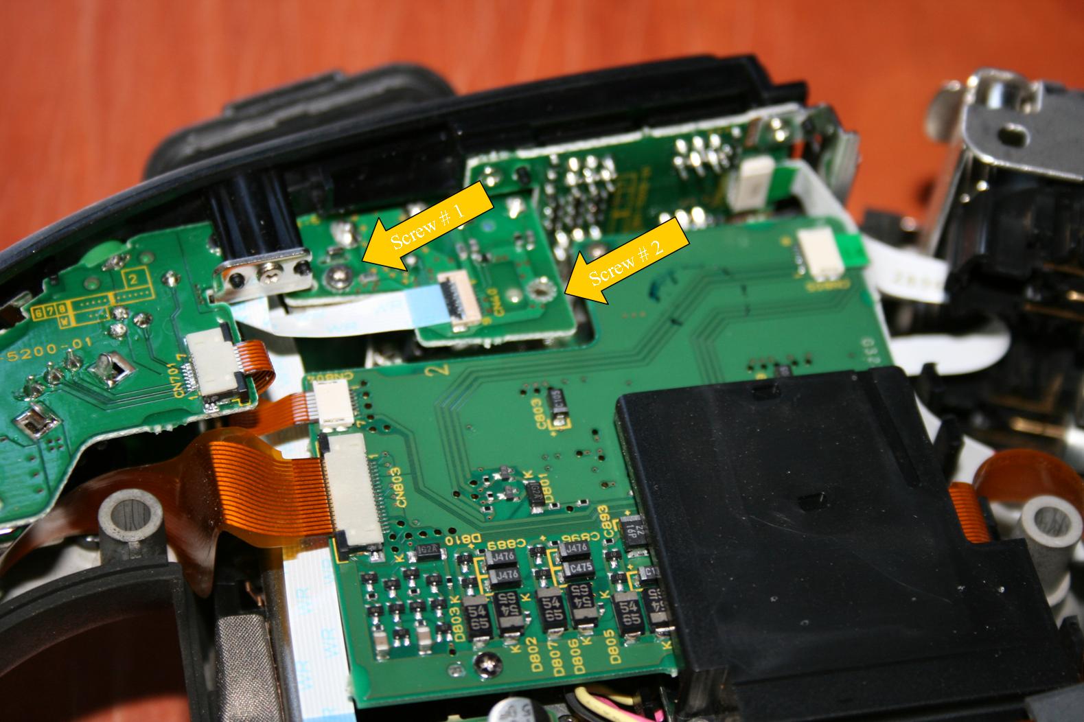

You have to be in Record mode not VCR mode. Then in the menu under "System" I've set custom key 2 to VCR Stop.
It's not majorly scary to open the cam. How skilled are you with tools? I'll guide you through the process. ( I give no guarantee however !! LOL)
The firewire board is secured with 2 screws and my guess is that one of the is rattling somewhere in the body. Be carefull as it could just happen that the little bugger might short out if it is wedged between circuit boards.

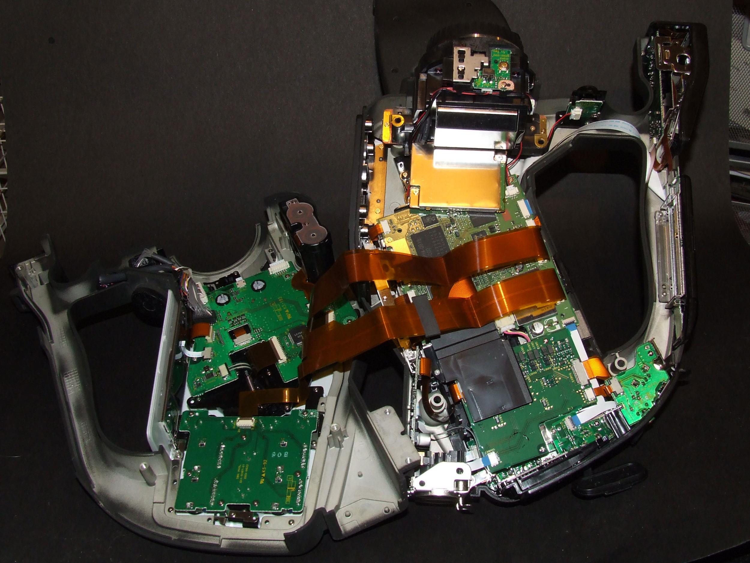

Well it only took a few weeks to pluck up courage but . . .

I meant to add that all is well now!
Still want to get it serviced properly though. This was just an emergency repair before flying to the States to shoot a corporate.
Thanks for the morale booster Björn !
Ian . . .

It's now time to strip my other XL2. Same problem as with all other cams. The firewire PC board is becomming loose again.
I wonder if I should do a step by step instruction leaflet and post it here. (and then while I'm at it also strip one of the XL H1 - just for good measure)
