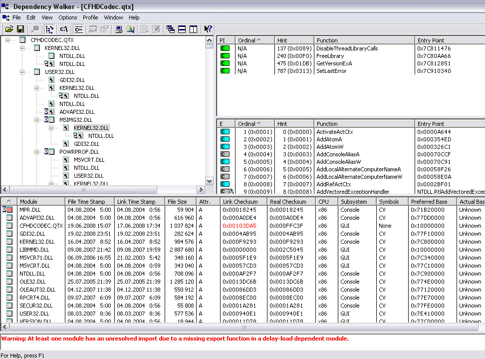

I'm afraid I don't know enough to tell which module - Dependency Walker doesn't appear to say which module is having the problem. The only indicator I see at all is that under the Module CFHDCODEC.QTX the Link Checksum is highlighted in the color red (0x00103Da5). I guess another possible indicator is that many (more than not) of the modules have an hour-glass indicator before them.

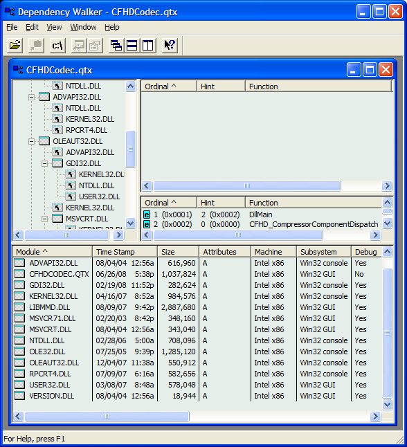

Are you sure you current have a valid CineForm license (even an active trial?) As that seem very weird. Theis is what I get from Depends.

I seem to have an activated Prospect 4K Version 3.3. This is what I get from Depends. Hmmm...
