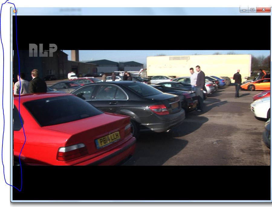

Please tell me I'm doing something wrong. I have exported 15 seconds of video and played it back inside windows media player and I'm getting this fuzzy line on the left handside.
See attached picture, project is a Cineform HDV 1440*1080i 50
I've uninstalled Neo V5 and installed 4.3 and the line isnt there.
Please tell me its a bug and I'm not going mad?
NeoHD/4K/3D v5.0 public betas now available-line.jpg

Doesn't look fuzzy to me, it looks like two layers of video, with one off center...

Now I'm sure of it. It's wrapped the right side back to the left, and is clearly the exact two or three pixels of the right side superimposed.
