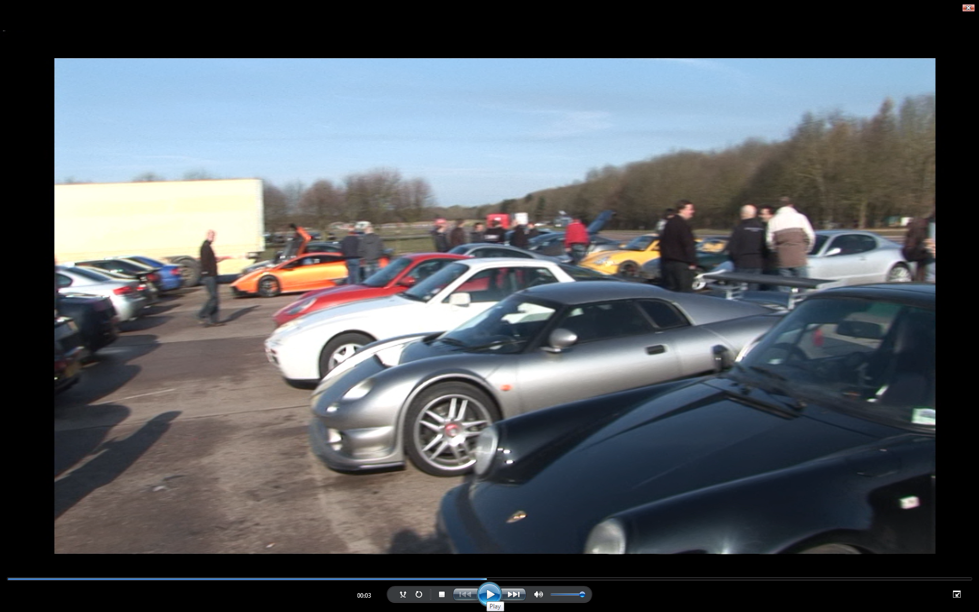

If its set to 90% the line is gone but there is just a little mark on the right still
NeoHD/4K/3D v5.0 public betas now available-mark.png
