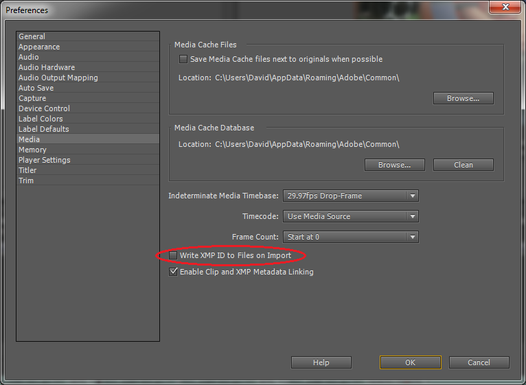

I wonder if this link (post 2) has any bearing on this? Maybe try turning off the "XMP switch"
Adobe Forums: Premiere pro CS5 will not stop indexing...
John Rich is offline   Reply With Quote

excellent find, yes an old Premiere bug -- it is get confused when writing the XMP ID.
Go into the menu Edit -> Preferences -> Media and turn off "Write XMP ID to Files on Import". Save the project after it generates the .pek files for the last (redundant) time -- it will not do on your next loads. This worked on a project of mine that always regen'd its pek files.

Posts: 1,435
Trying this fix now... stay tuned...
