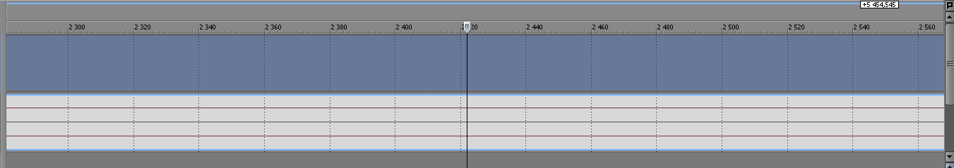

Dan, we went through this months ago, and I stopped using my nF after that (what is the point of using it if I cannot get any sound out of it?).
It plays in VLC, but there is no sound in Vegas. Not in 9.0c which I used back then, not in 9.0e which I use now.
As you can see in the picture, the entire sound time line shows nothing. And no sound plays either. None whatsover. Nada. Zilch.

Dear Adam,
I wanted to be certain what you meant by "that" problem.
Your situation is unusual.
As I understand it:
You can record video and audio in your nanoFlash.
When you play back the files in your nanoFlash you have video and audio.
When you play the files in VLC Player you have video and audio.
When you play the files in Sony Vegas 9.0e, you have no audio.
This certainly sounds like a Sony Vegas problem to me.
Just yesterday, one of my friends had problems with video capture with his Sony Vegas 9.0e. A simple download and re-install fixed the problem.
As far as I know, no one else has your symptoms.
I just checked my Sony Vegas 9.0e, using one of our sample files with audio, and it plays fine.
