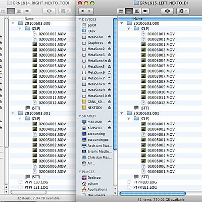

I am having some problems with footage shot today on 2 Nano Flash units that perhaps others have had before and can offer possible solutions.
The one consistency with the files is that all of the files under 3.51 GB file size are corrupted (or unable to be opened).
I have loaded the new firmware into both units and this is the first shoot with it. It's a 3D shoot so that is why there are matching file numbers but the problems span both NF drives and these are the original CF cards not a transfer.
Recording details: I-Frame Only 140MBs
I'm hoping these files are salvageable, so if anyone can offer any advice to help out I would be most grateful and I'll monitor this thread hourly. Fortunately I am in Los Angeles where the C-D team is hanging out this weekend for Cine Gear show so I will be showing them the CF cards probably tomorrow. Again, if anyone has had a similar problem in the past, please advise as to a procedure to rescue the data files.

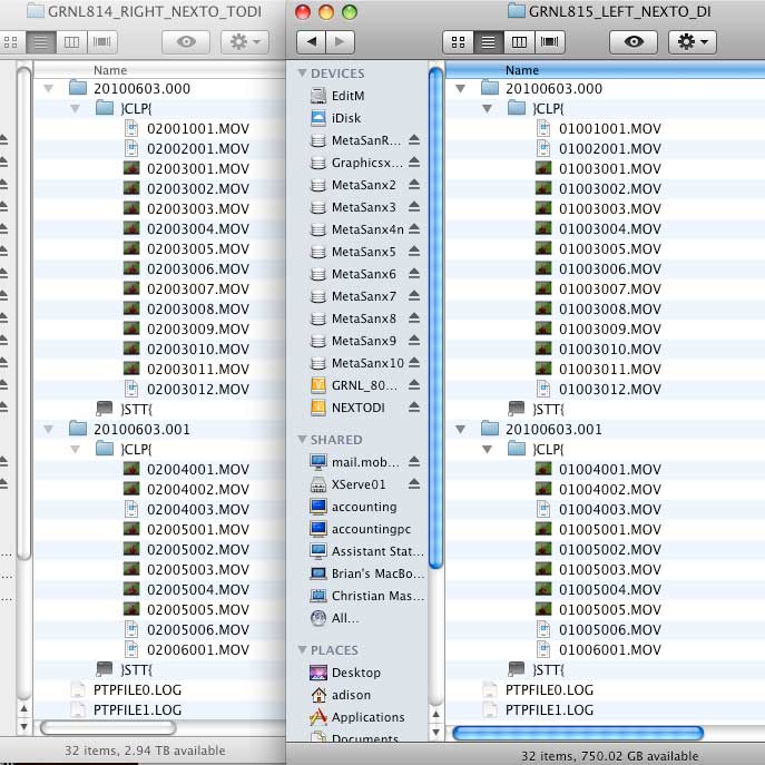

Ok, I was able to salvage the files because I had not erased the CF card originals. On a hunch I put the CF cards back in the Nano Flash and hit Play. Even the corrupted files played out, so having 2 NF units I was able to run an HDSDI cable from Play NF to the other NF and Record. The files themselves were not preserved as one clip ran into the other but the timecode being synchronous should make matching the two data streams easy in post.
Whew! Client is happy, and I am reverting back to the previous firmware. I'll be discussing this problem at length tomorrow with the mavens at C-D at Cine Gear Expo and will report back what we find out. It appears at first sight that the transition from one clip hitting maximum capacity to another one starting up is not working properly - but not always.
