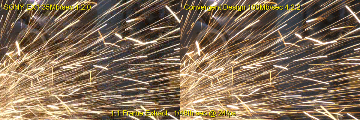

Dear Friends,
Here is an image with lots of detail and movement for comparison purposes:
Dan Keaton
Augusta Georgia
