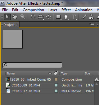

Actually, here is another tip for editing clips using Dynamic Link - I have found a bug when reopening/re-editing Premiere projects with Dynamic Linked clips. For some reason, After Effects doesn't always link to the original source video clip. In AE, you can see this bug in the Project window. The video clip icon looks different. Here is a screen shot. The one in the middle is the linked source but it should look like the one below, which I just used the import function. When re-opening the Premiere project, AE doesn't 'see' this clip, which requires importing the clip and replacing the video layer in the AE comp. If done at the very beginning, it is not difficult. What you do is: click on the imported clip (in the Project window) and drag over the 'linked' layer (on the timeline) while holding the Alt button, and release the mouse button. This replaces the layer with the imported video.
