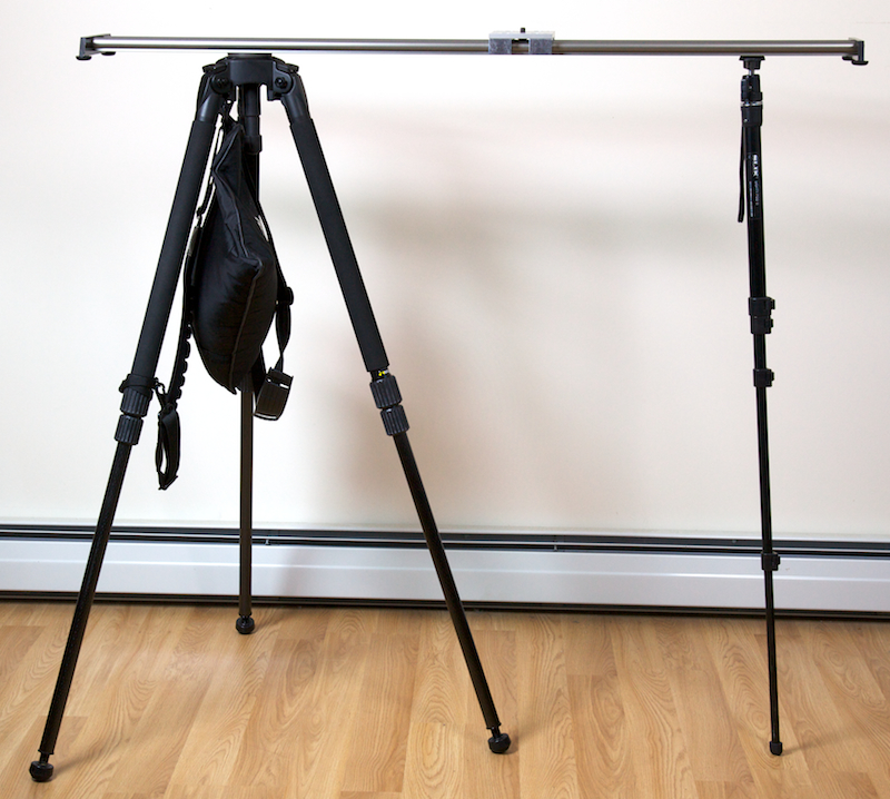

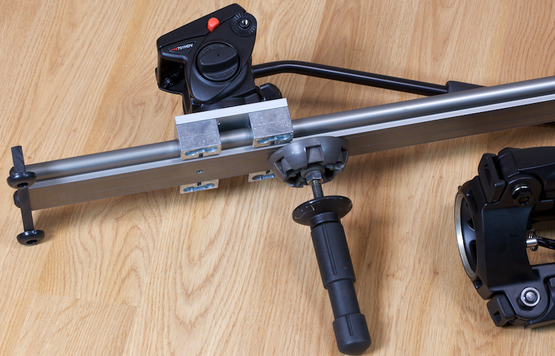

Damian,

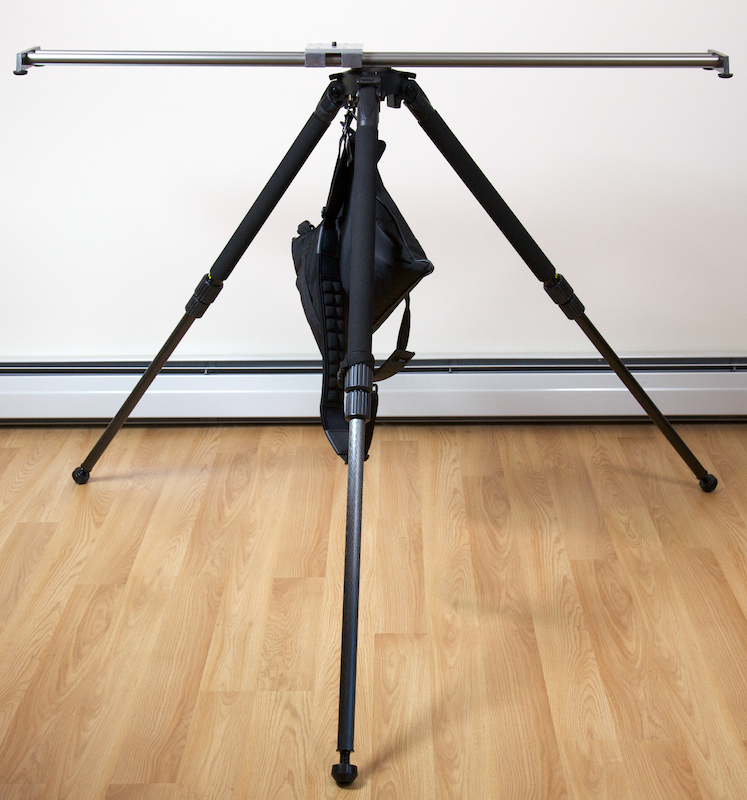

I use Miller Solo Graphite legs and DS10 heads myself. I really like the sticks and heads. Spreading the legs to the middle position makes a 1 meter track quite stable on one set of legs, hanging a sandbag from the sticks helps keep things stable. I don't recommend leaving the camera on one end or the other with rig unattended with a 1 meter track on a single tripod.

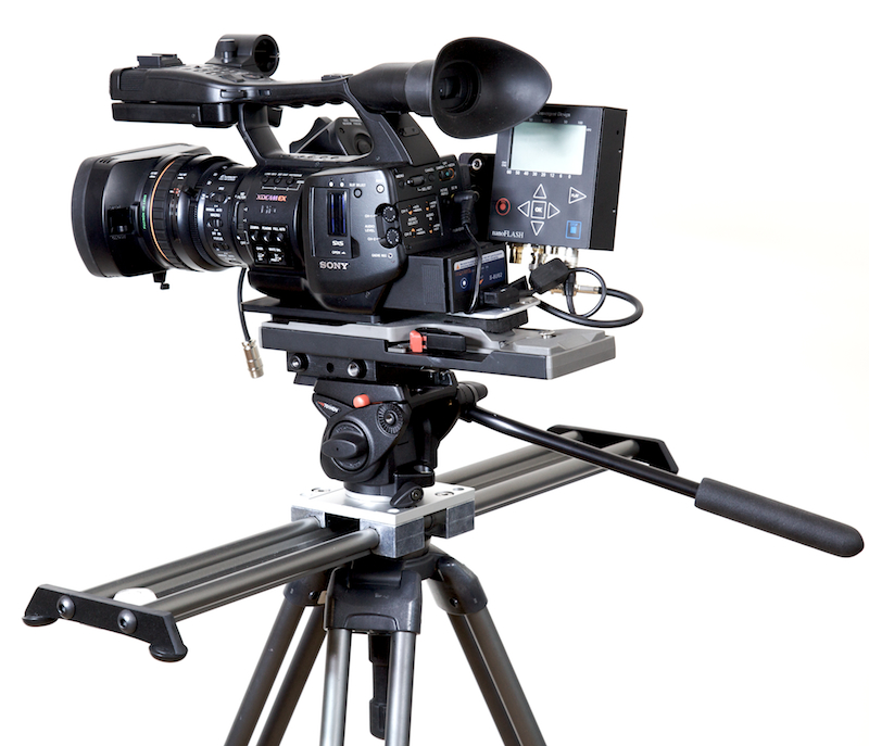

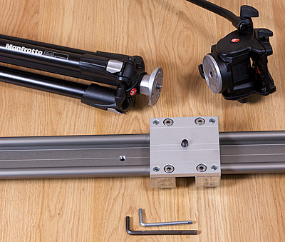

I use a Manfrotto 701 head (it has a flat bottom and a 3/8" tapped hole in the bottom) on sliders for EX1 and EX3 now, it keeps the CG nice and low:
Manfrotto | 701HDV Pro Fluid Video Mini Head | 701HDV | B&H

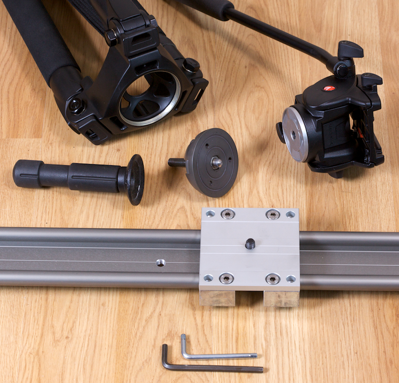

I use a Manfrotto 75mm bowl to 3/8" stud adapter on the miller sticks to mount the track:
Manfrotto | 520BALL 75mm Half Ball | 520BALL | B&H Photo Video
This makes it really easy to level the track. You can also run the track on a tilt for a jib up/down effect, just make sure horizon is level and don't pan (unless you are going for a special effect).

If the 501 has threaded flat bottom like the current version, it would work fine:
Manfrotto | 501HDV Fluid Video Head - Supports up to | 501HDV
You would need a flat top for the sticks with a 3/8"-16 threaded bolt like this:

I have been using this system now for over a year, and I have not found it necessary. There is a bit of resistance that keeps the truck in place. To start moving it has the same feel as a liquid head, there is some resistance, but that helps you make smooth moves, stops and starts.
Yes it is possible to put a lock on the track. I will be offering this as an option, it will simply be a nylon bolt that can be tightened onto the track through the truck. This could be useful if you run track at a slant.
I found about a 7º tilt is enough for the truck to slide slowly on its own. A nice effect. This will vary with the weight of your camera and head setup.

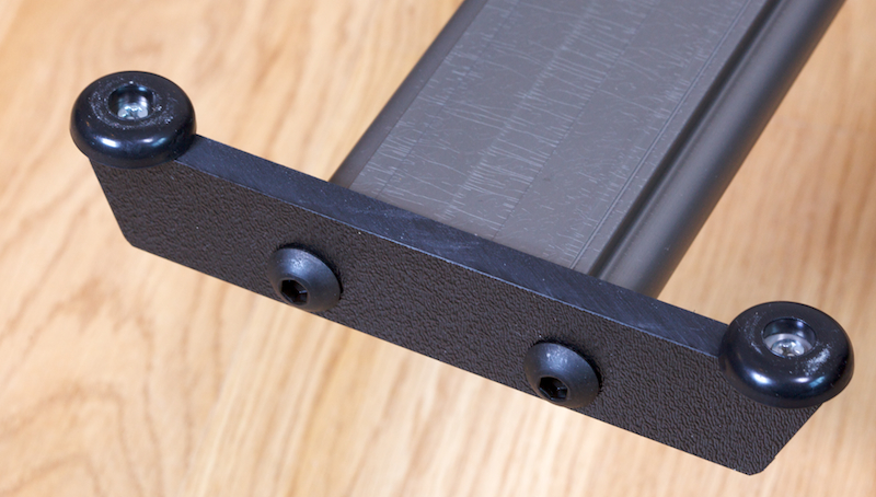

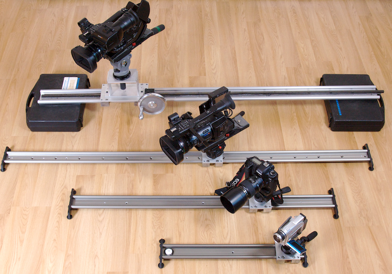

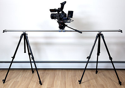

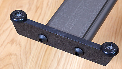

Here are some more details photos and actual setups I use.
I just finished shooting the family portrait.
I will soon have all the info on my website and you will be able to place orders there.
You can still order by email or by contacting me.
If you have any questions or comments contact me:
olof@westsideav.com
603.383.9283
Reasonably Priced Sliders available now-slider_family_portrait.jpg   Reasonably Priced Sliders available now-slider_feet.jpg
Reasonably Priced Sliders available now-4ft_tri_and_mono.jpg   Reasonably Priced Sliders available now-sanbag_millersolo_middle_spread.jpg
Reasonably Priced Sliders available now-slider_2ft_ex1nanoflash.jpg   Reasonably Priced Sliders available now-slider_6ft_dual_tri.jpg
Reasonably Priced Sliders available now-slider_bowl_detail.jpg   Reasonably Priced Sliders available now-75mm_bowl_parts.jpg

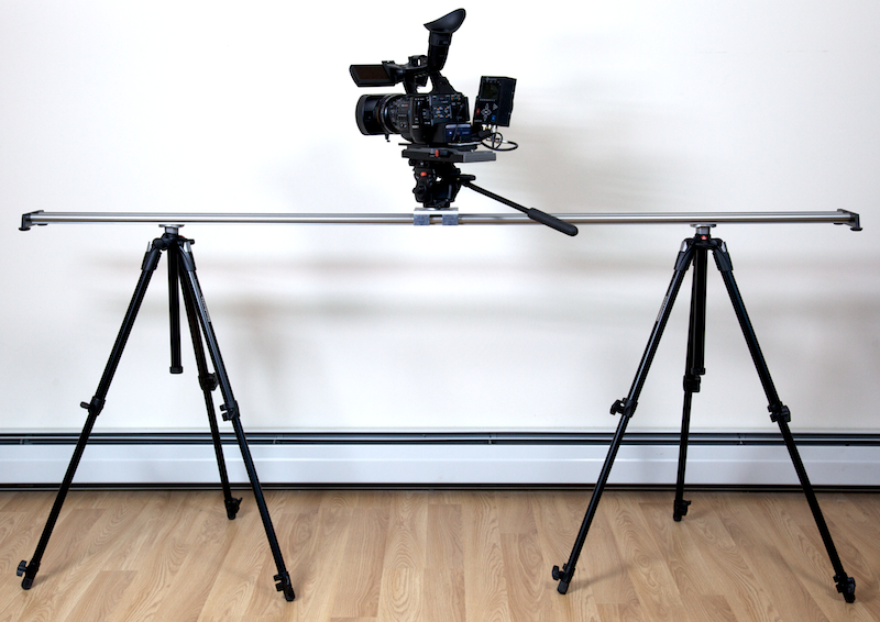

Oops one more photo. You don't have to use a use a tripod with a bowl.
It is easier to level if you use only one tripod.
I often use 2 light Manfrotto tripods with my six footer. It is really easy to carry around. Just fold the legs in and carry rig on your shoulder, it is well balanced and light. Be careful though if you leave the camera on the truck.
