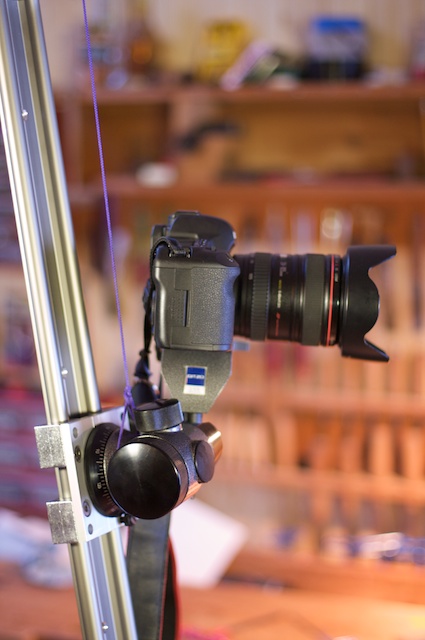

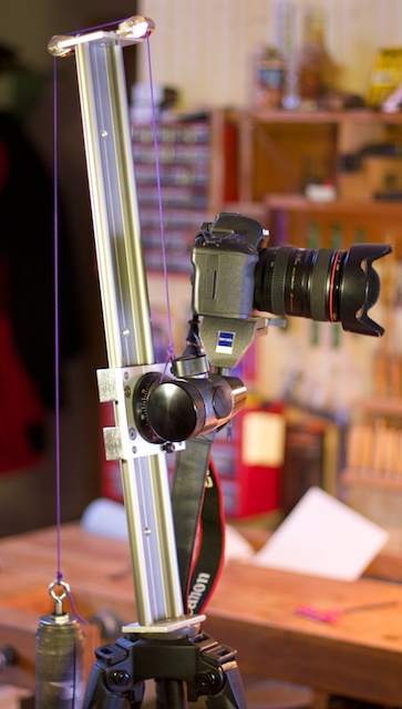

Terry, here are 2 photos of my slider with vertical kit.
I made this setup with a counter weight, so that the camera can be left at any point and stay there. It is a very simple addition of a plate on the end of the track that attaches to the tripod.
The counter weight is optional but a very nice touch if you use the rig vertically or close to vertically.
The standard track can be used at any angle, and use of a "ball head" makes this very easy. I can supply all these parts or you can adapt the system yourself.
