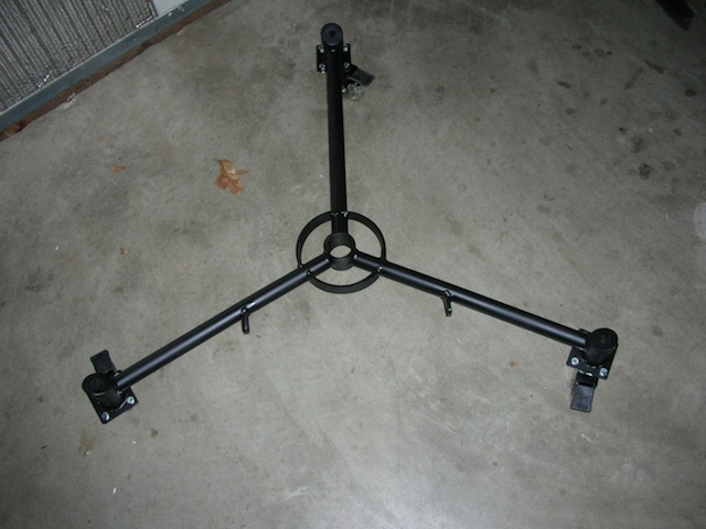

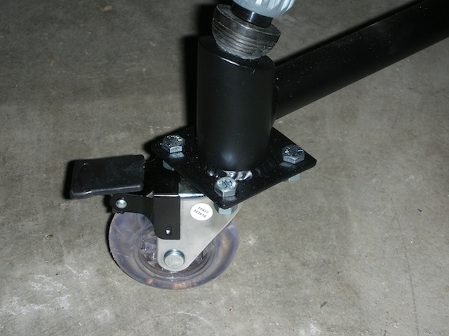

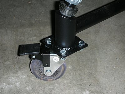

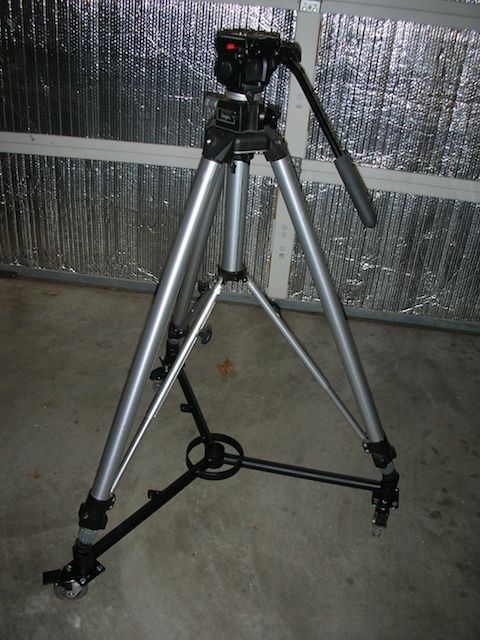

I made a dolly using rollerblade wheels I found at Harbor Freight Tools. The wheels caster and
have brakes, makes it a little more stable if you want to stay in the same position. The
rollerblade wheels work fine on hard surfaces including driveways but they don't work very
well off road.
Air Filled Tires for a dolly?-dolly-732.jpg   Air Filled Tires for a dolly?-dolly-737.jpg
