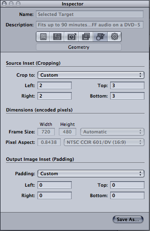

What about if you add some 'source inset cropping' in Compressor. As the output will remain constant what ever you inset the crop at, you will just distort the image if the ratio is out.
See grab:
Green halo around frame after compression? Need help have to deliver video today!-picture-10.png
