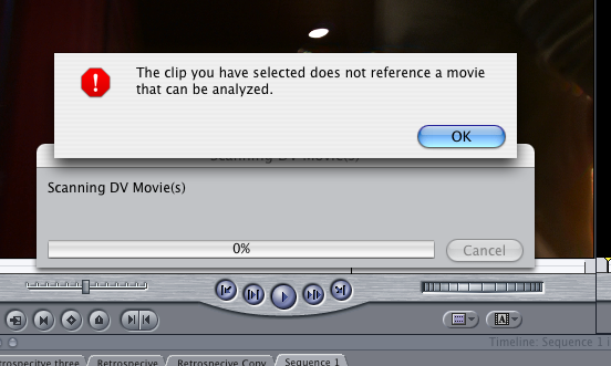

Originally Posted by Larry Huntington
"...and I already did uncheck the box that says "Create new clip on Start/Stop".. but its still happening."
Oh, and Michael...
If your capture settings are not listening to you, take your FCP User Data folder out of the user/library/preferences folder and drag it to your desktop. Then try things out. If that fixes this, then your prefs got corrupted. If it doesn't help, drag the folder back and replace the new one and try something else. I do this once in a while when weird things happen.
YESYESTHANKYOUTHANKYOU!!! IT worked.. I got clean audio + no dropped frames when importing using hdv-108024p! I was right.. you do RULE!
Question though: why won't it allow me do to a dv start/stop detect?
-M
