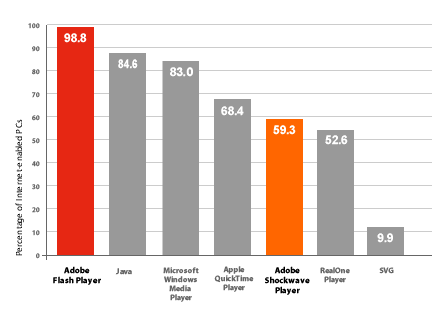

Is Flash the best online player?
According to Adobe (Millward Brown survey, see http://www.adobe.com/products/player...s/flashplayer/ or attached picture), as of December 2007 almost 99% of computers have the Flash player installed. Next would be the Windows player (83%) and QT with only 68%.
Add to this the fact that the QT install is about 32 MB (plus takes for ever to start up, and it's buggy on PC, especially when it comes to embedded players!) compared to only 2 MB for Flash 9, it's a no brainer - it is the best player if your goal is to reach most prospective visitors with your video on your website.
But a good Flash encoder doesn't come cheap - free FFMPEG only supports Flash 7, much inferior to Flash 9 - ON2 is out of question for most independent video producers ($3.5K per year - is this correct? - I find it insane).
Now, with the added support of H.264, which comes, in my opinion, with a much better quality for the same bit rate compared to Flash (comparable to WMV9, possibly a bit even better), it's REALLY a no brainer... Flash ROCKS!
