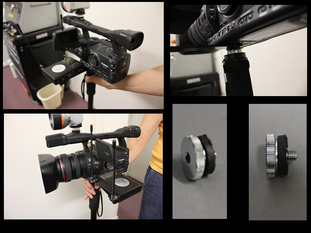

I came up with a custom attachment that gives me a cold shoe mount on the left below the LCD screen, which is where I put either a light or the wireless receiver, depending on the situation.whether I need direct or indirect on-camera lighting ("run and gun" and people wearing glasses, for example). It attaches between the camera and a monopod or fig-rig style holder, for example using a male/female screw in with a rubber gasket that I stumbled into.

The main element is one of these: http://www.bhphotovideo.com/c/product/179985-REG/Sony_VCTS30L_VCT_S30L_Cold_Shoe_Adapter.html which I picked up at a garage sale or something. The screw on most monopods doesn't seem to be long enough to feel safe so I ran across a strange male/female adapter with photo threads to solve that problem (shown in the inset below). I use this rig in a kind of run-and-gun mode for interviews at trade shows (YouTube - Resnet 2011 - PENTAIR).
