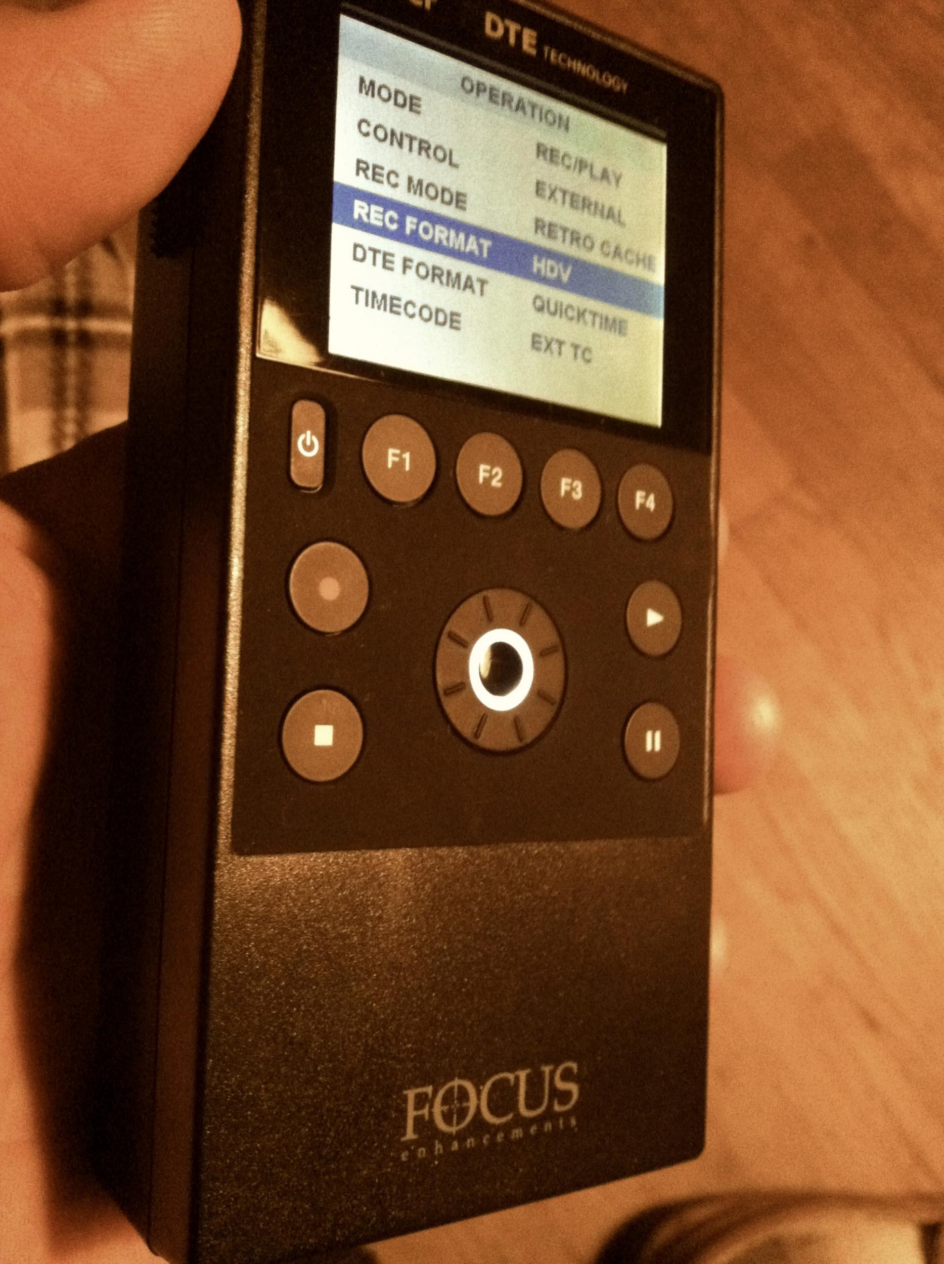

Well Derek, if the playback isn't that big of an issue, you may find the non-pro version a plus. But I'm with you on the metadata info, I do a number of promos, and it would be so nice to at least log some basic info in advance!
I've attached a picture of the unit I have. It does appear to have the scroll wheel; much like the earlier iPods. East to navigate, much more than the FS-4HD!

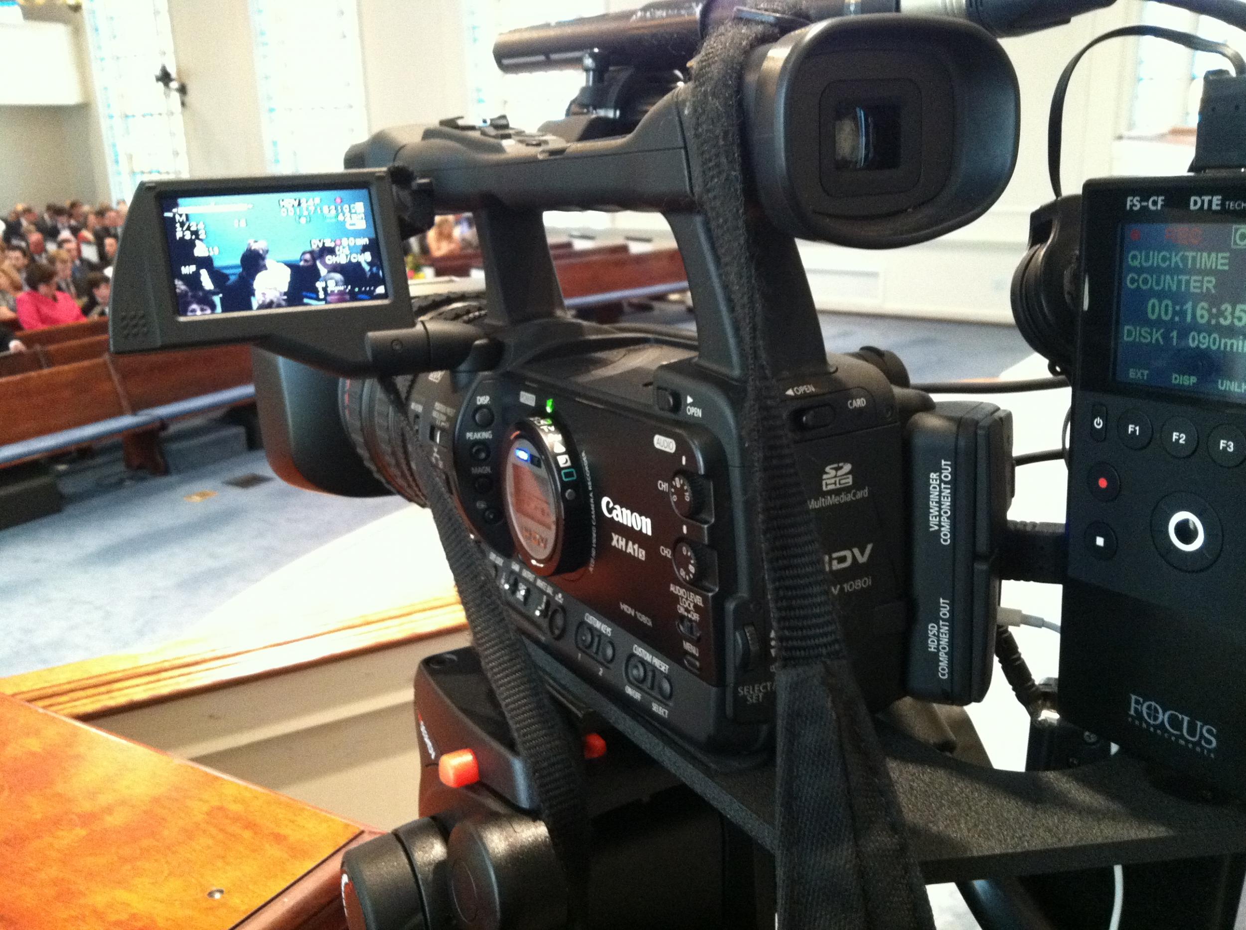

and the FS-CF on Control: External SO, the BH guy was actually correct, you can control through the camera, or independent. Just not sure about toggling when you are using one method or the other...
BTW, I use the BEC-DVCAMB-HD bracket to mount the FS-CF on my Canon XHA1S (Sony EX1 - EX3 Bracket Panasonic HVX200 High Definition Video Camera Accessories The BEC Group it makes it a little right side heavy; but a very solid braket, adding weight towards the back of the camera. I may try to counterbalance it a little.... somehow!
