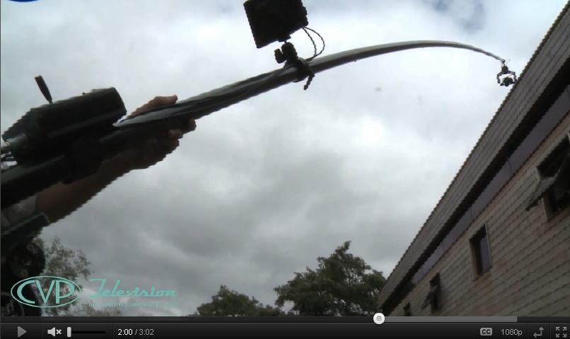

Buba, have you actually used a polecam? Is your comment based on actual user experience, or theory? How wobbly was your footage? Just asking because I was contacted privately by 2 polecam owners that aren't registered on dvinfo, but they did say the CF poles do not flex. It is also my understanding that new poles are now being used with the starter pack that are even sturdier to handle additional weight.

do not flex? I don't think so, but even if they wouldn't I don't see anything I would pay $10K , BUT
