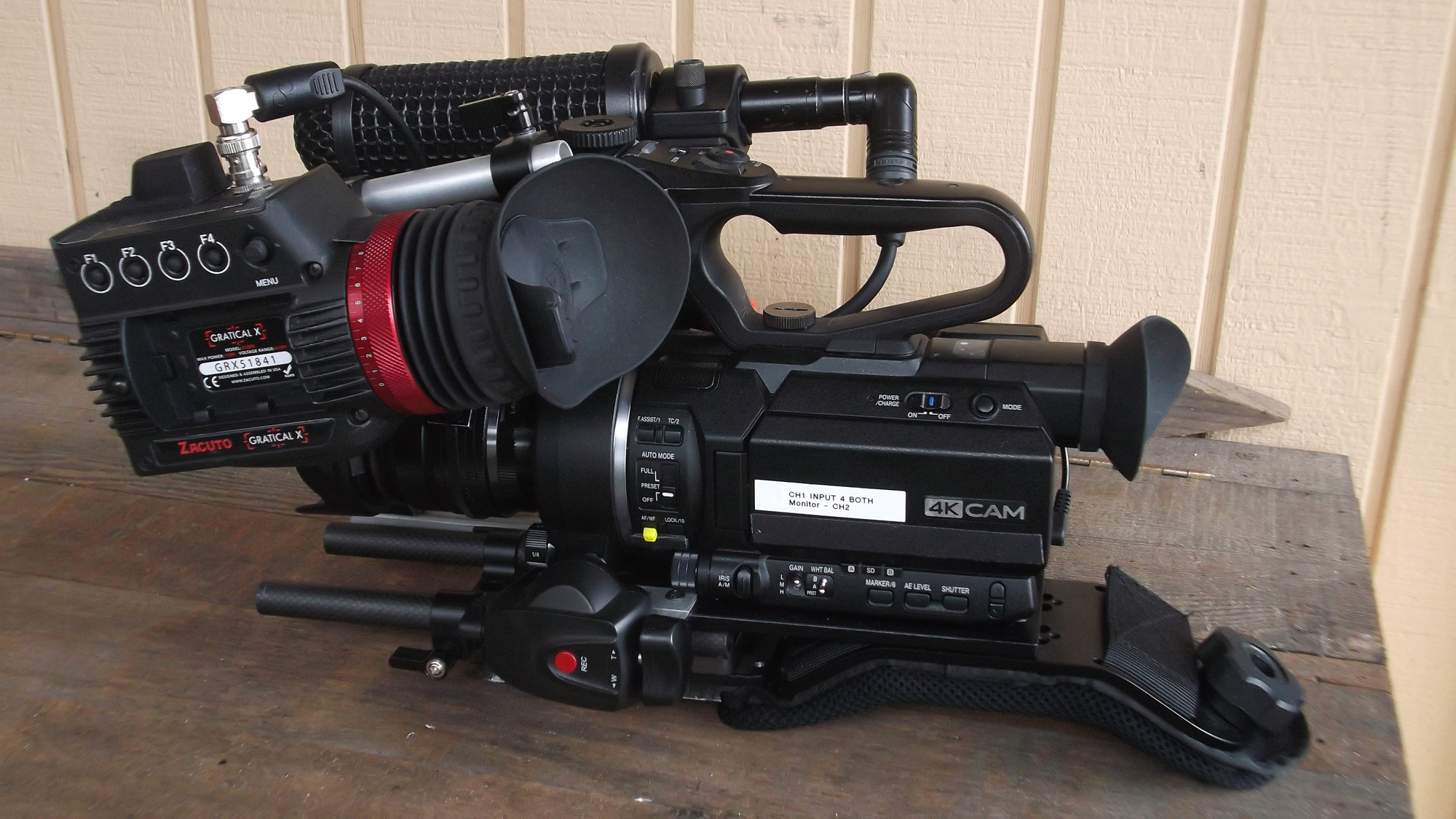

If someone would tell me how to successfully post a picture on this site I will put up one of my LS300, which uses many "parts" I had created for my AF100.
Simply put, a lower than stock 15mm rail block (keeps the CG down) under the front on a camera-base size aluminum plate - the rod block Contigo makes for the Pocket Camera is perfect, but there are others like SmallRig.
A SmallRig shoulder pad attached behind the block to the plate under the rear of the camera.
A pivoting rod block mounted vertically on an L bracket off the handle.
An EVF (I use a Gratical or a Z-Finder) with a vertical rod block on the side, rods sliding back through the one on the camera (the eyepiece can mover forward and back and tilt for tripod work).
A vintage Aaton grip for the front, on a custom bracket on a rod block so it can slide backward and forward.
I realize this sounds confusing, but if I can ever get a picture up it'll make sense.

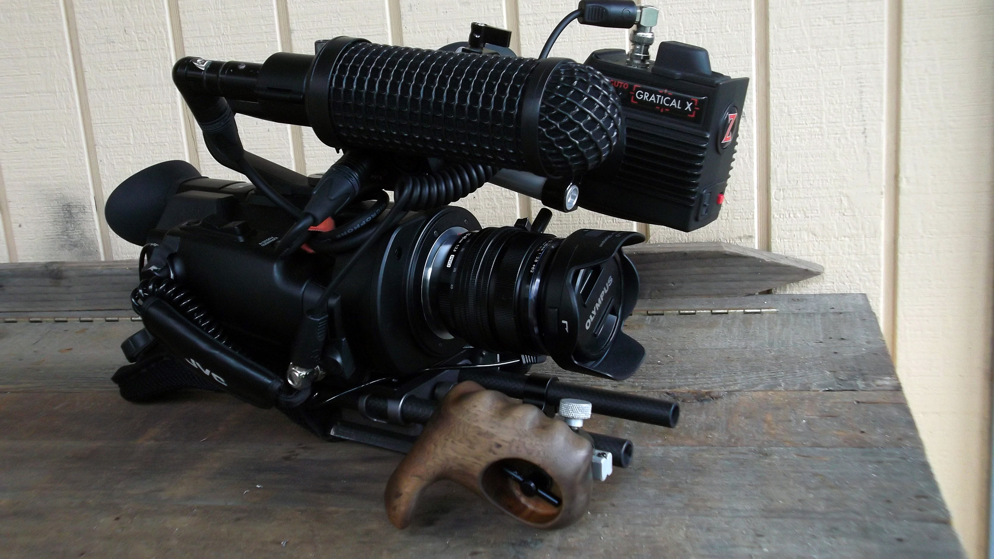

I'll try one more time.... Okay, the jpgs are there but not visible on screen, so you have to click on them... Can anyone suggest another way?
Anyway, this is the setup I've been using for several months, and it's perfect for me... Light, small, and very efficient...

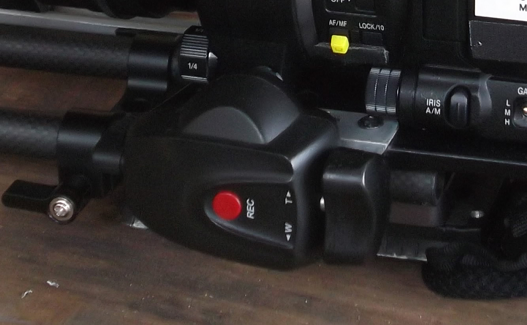

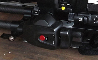

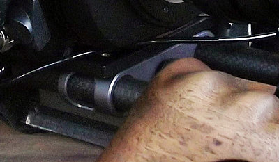

I'm adding two closeups, cut from the wide shot. One is the $89 controller from B&H that works perfectly with the LS300, and since the firmware upgrade I can zoom smoothly during a take. This placement lets my fingers know where the ND and iris dials are without moving my eye from the finder (it's placed in the center, mounted off the base plate).
The other is the Contigo (ViewFactor) rod block that can be bought separately from the Pocket Camera cage they make. Get it with the available bottom plate and you can attach a tripod plate. A little pricey but really slick and easy.
The rod block is screwed below and to an aluminum plate that I made. It's the size of the bottom of the camera and has a 1/4-20 set screw and a pin for keeping it from twisting - it's one of those measure twice, cut once projects, but doable with hand tools. (I had it powder coated black, but you could paint it or leave it bare metal).
Hope this helps...

Thanks so much for posting those, Steve. Gotta say, that's a pretty badass looking setup. Is that rod block 60mm spacing (with 15mm rods)? I've seen plenty of pics of the LS300 in peoples' hands, but it still strikes me just how small it must be.

Dave... I've tried several LANC controllers and not all of them work with every camera. I have a wooden movcam grip for the Pocket Cam that works with the LS, but it's sluggish and sometimes takes three or four punches to start the camera, or stop it, so you've got to be constantly paying attention.
The advantage of the one pictured is that, not only is it cheap and works well, but mounted where it is its comfortable for both handheld and tripod without re-rigging. And, as I said, positioned where it is it guides my fingers to the ND and iris wheels.
The Viewfactor rod block is standard for 16mm cameras, I don't remember the distance. I got it with the cage for the Pocket, but that camera looks ridiculous perched on top of the column it comes with, so I use just the block and the baseplate on the LS instead.
What you cant see well in the pix is the simple L bracket that is mounted on the cold shoe off the handle to mount the EVF. At first I was concerned that the construction of the handle might be sub standard and unable to support the Gratical... But I've been using it for over 4 months almost daily and its not showing any signs of fatigue... But I do take very good care of my tools and am pathologically careful...
