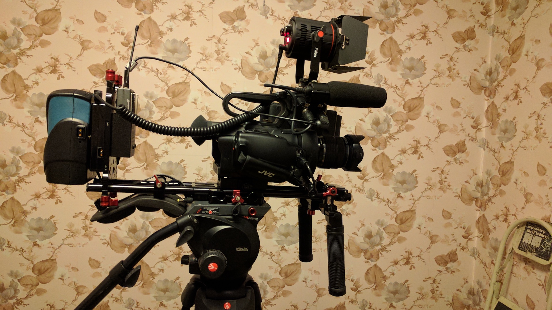

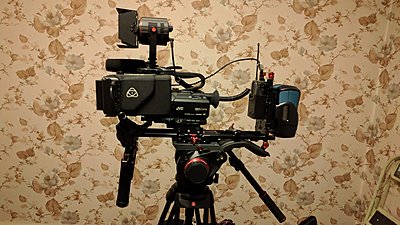

Greetings. I'm new to this forum. I recently sold my Canon C100MK1 and purchased a LS300. The LS300 has the latest firmware upgrade. I often will be using this camera to shoot short ENG style interviews. I will be recording in HD to an external Ninja Blade via HDMI in ProRes 422 and internally in the camera in 50Mb 422 .mov. The internal recording will be a backup to the Ninja Blade. The person conducting the interviews will be editing using FCPX. He prefers I not use J-Log. What camera WDR and Color Matrix settings would you recommend to get the most natural looking skin tones? I will be shooting outdoors in sunlight and indoors. I have a variable color temp LED light mounted on the camera. See below.
