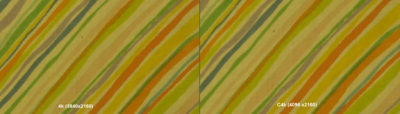

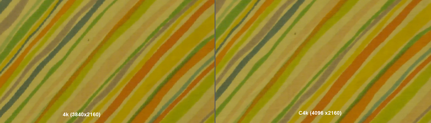

Re: Firmware 3.02
Tested out the new 3.02 firmware, but the scaling error / stepping artifacts in 4k are not fixed yet.
Reported this to JVC months ago, no reply. Hopefully they'll fix this in the next major firmware update.
Maybe if more folks chime in to JVC, they might bump this up on their priority list.
Attached stills extracted from 4k (3840x2160) vs C4K (4096x2160). There are no stepping artifacts in C4k, but in C4 (UHD) diagonal lines look pretty ugly.
ISO: 1600
JLOG1
Shutter: 1/48
fps: 24
After looking deeper into this it seems it may have nothing to do with JVC, and there may be no scaling error at all. It seems to be a playback issue with MPC.
Last edited by Steve Ritchie; February 1st, 2017 at 08:49 PM. Reason: New information.

It's hard to tell which one looks better isn't it? A more regular test subject may have helped.
