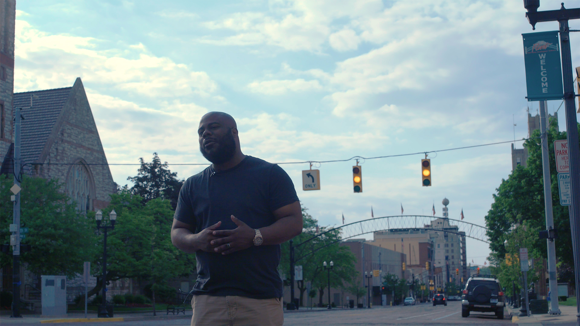

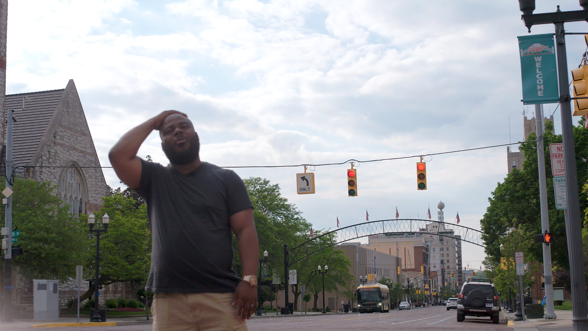

follow up dumb question. are your two pics from each camera or was it from your point and shoot to simply show the lighting and setup? If so can you upload a still from each camera?
Yes, just to show my point of view. they were not screen grabs.
How ever here are screen grabs from that session:
First one sun behind clouds and second one sun beaming out. Both images are screen grabs from the LS300 cam after a slight color correction.
Horrible Day W/ The LS300-sun_gone.jpg   Horrible Day W/ The LS300-sun.jpg

first thoughts. Especially for darker skin tones I think it's vital to expose Jlog as 400 (0 gain) and slightly over expose for the scene... (old school film expose for the shadows vs video which is to protect the highlights) I can bring down the exposure a lot and retrieve detail in the sky with curves in my NLE... (via plug in for FCPX or latest FCPX) as well as any other modern NLE.
It is true that we may lose 1 f-stop of dynamic range, but we gain a cleaner mid tones and darker tones without noise, and thats true with all cameras. It also means that with JLOG and exposing just a little over that it will always mean some post work.. though I set up my custom filter preset and drag and drop on timeline and it's accomplishing 3 or 4 tasks at once that have me ballpark about right and quickly.
Also the latest 422 update that I have yet to preform myself might help.
I don't have enough first hand use with the better Cine incident/spot meters from Sekonic, I had the 308S 308C that burned up in the fire... and they annoyed me since they did not have ND filter factors in them.. so I would get a reading like f22 then I would have to add ND on camera and figure out what the meter would be telling me.. (PAIN) that's why I like the newest light meters that have filter info in the meter just like that new iPod app (with Lumu ball plug in meter) If I don't like the f-stop reading in the meter (f22 for instance) I can click on the app, adjust the ND filter factor from zero up to 1/1024 (0, 1/2, 1/4, 1/8, 1/16 etc) that matches our JVC's. and pick our aperture on the lens to match. Then look at skin tones and and probably set custom zebras to buzz on the skin tones that best match our shooting styles. That would be 1 method.
But regardless a good Cine meter is $400 and up to $800 but probably well worth it, and good for all cameras now or in the future. In the meantime I'll work with old iPod touch as a stopgap.

There is also a LOT of data there that you can still adjust and push and pull, though going too far at 420 it will start to fall apart.. the latest update 422 I hope will help a lot.. with lifting the shadows and burning in the sky with applying a S curve to the exposure. I'm not saying it will compete with 444 Raw, but I'm amazed at what I can squeeze out of the JVC at 420 that I would not have thought possible.
What software are you using?
