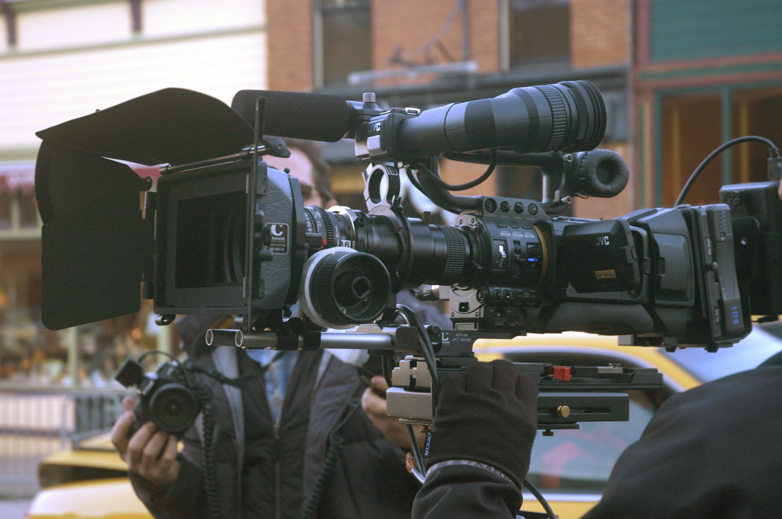

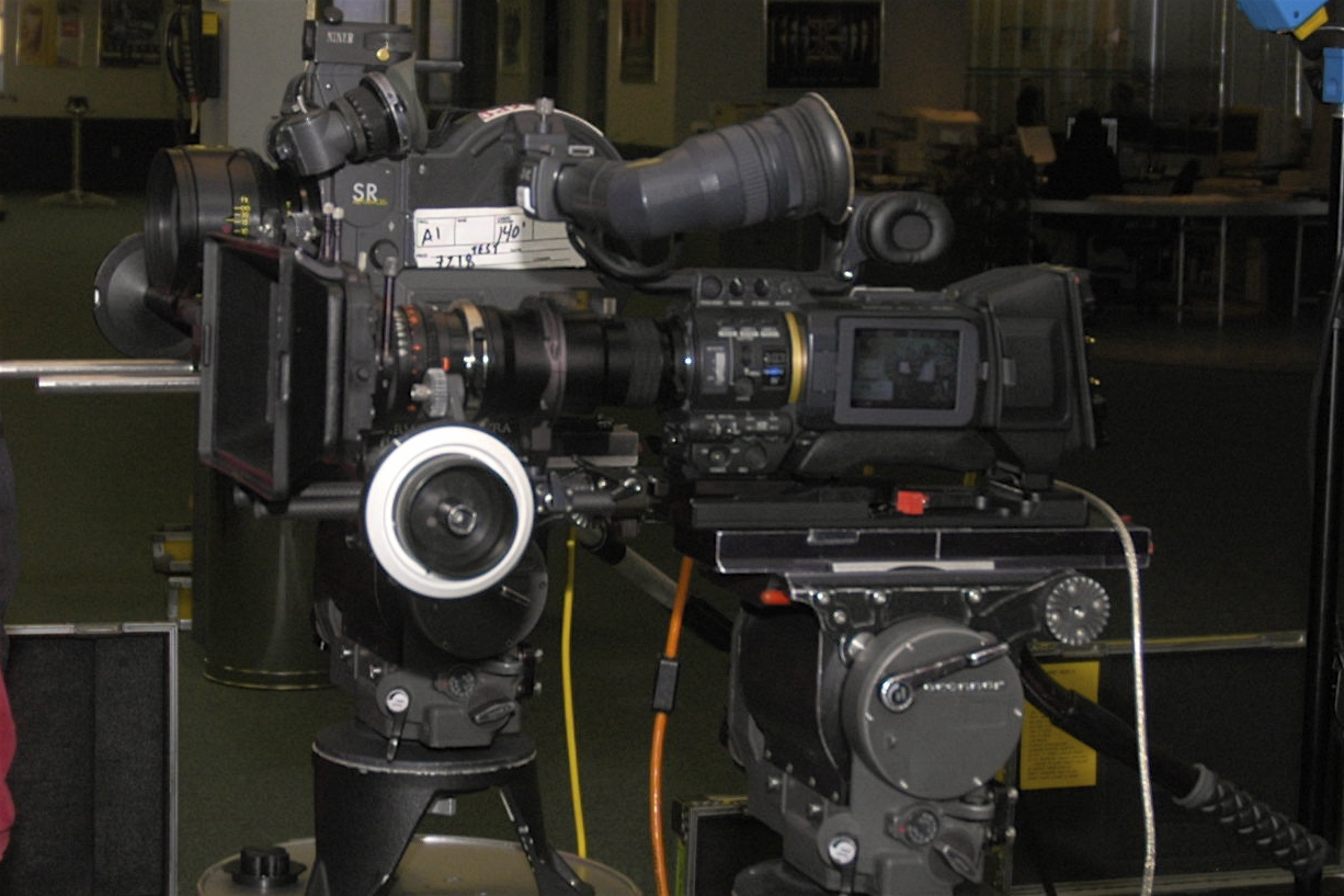

The HD200 display model in Sundance had the Chrosziel adapter and the first thing I noticed is that the vertical offset prevents the HD200/250 from taking advantage of the back support of the plate, therefore resting all of the weight of the camera on one point. However, when using the Cavision style system, everything fits as it should, with the weight of the camera evenly distributed.
I've attached a photo of each. (Chrosziel 401-64 mounted on Stedicam, Cavision RSPU + RS1525 on head) Sorry for the poor quality, the second photo was cropped from a much larger photo.)
A little of topic, sorry, but Tim, what adapter is that on the camera in the photo with the Cavision rod system on the tripod? Looks like the new 16mm lens adapter... is that correct? Thanks,
Yep, the HZ-CA13U in both photos. I've spent some quality time with the prototype and will share my findings in the weeks to come. Bottom line: awesome!
