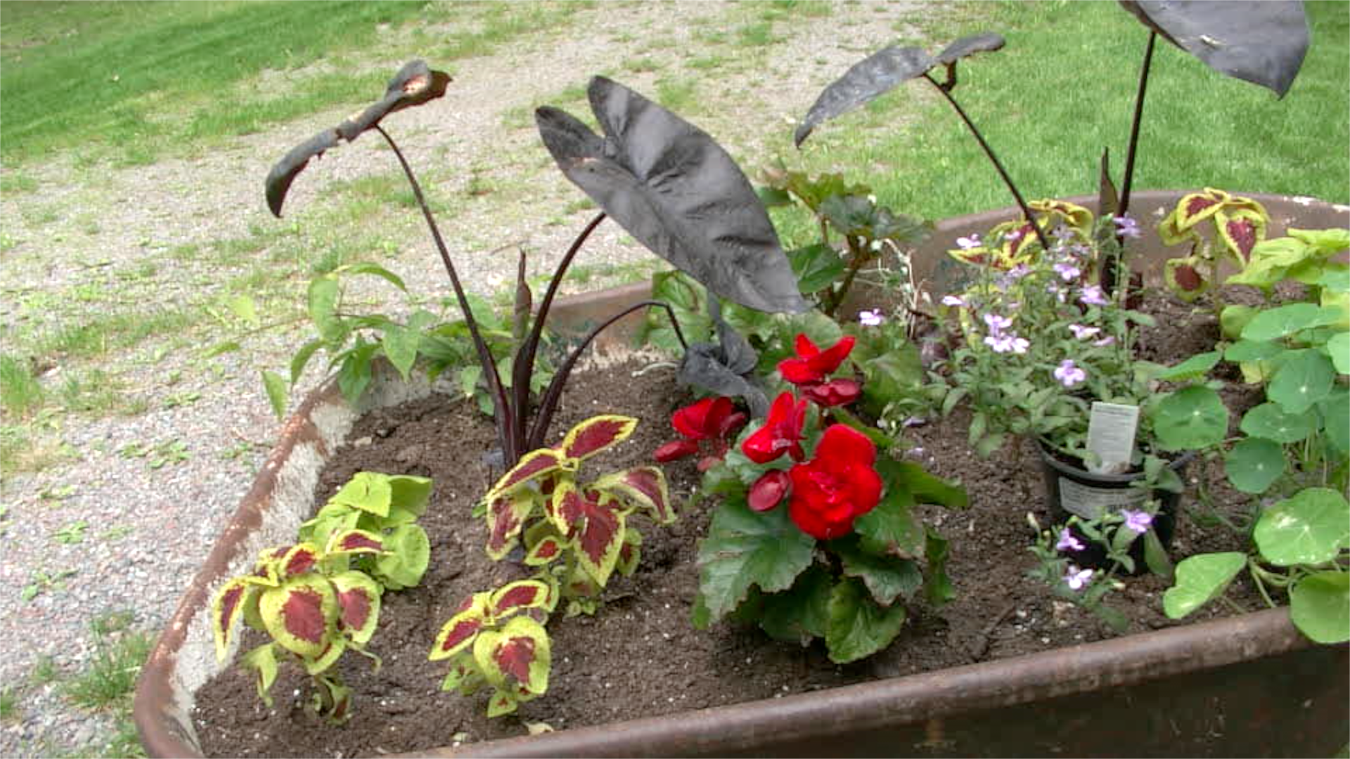

Steve - thank you for all the great details and the test shots. While I look at the one video with the red Begonia I'm puzzled as to why it appears to be either out of focus or over saturated with color. The one bloom that is the least distinct does appear to be closest to the camera while the other blooms and their leaves behind it appear to be more detailed.
Is that what we're seeing, a depth-of-field effect? Or is the red color over emphasized? Or both?

Over saturated in the YouTube compressed footage.

Hi Steve - that's some informative testing. By the way, you've got some pretty good-sized trees around there so it's no wonder there are power outages when storms roll through.We get our share here, too. Electrical power and trees with wind storms don't mix very well, hence the generator in the garage.
What is the chance of getting a photo posted of the red flower so we can see what it looks like without the YouTube processing involved? I'd really like to know what it looks like in real life without their digital re-processing.

FREEZE FRAME OF FLOWER:
