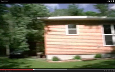

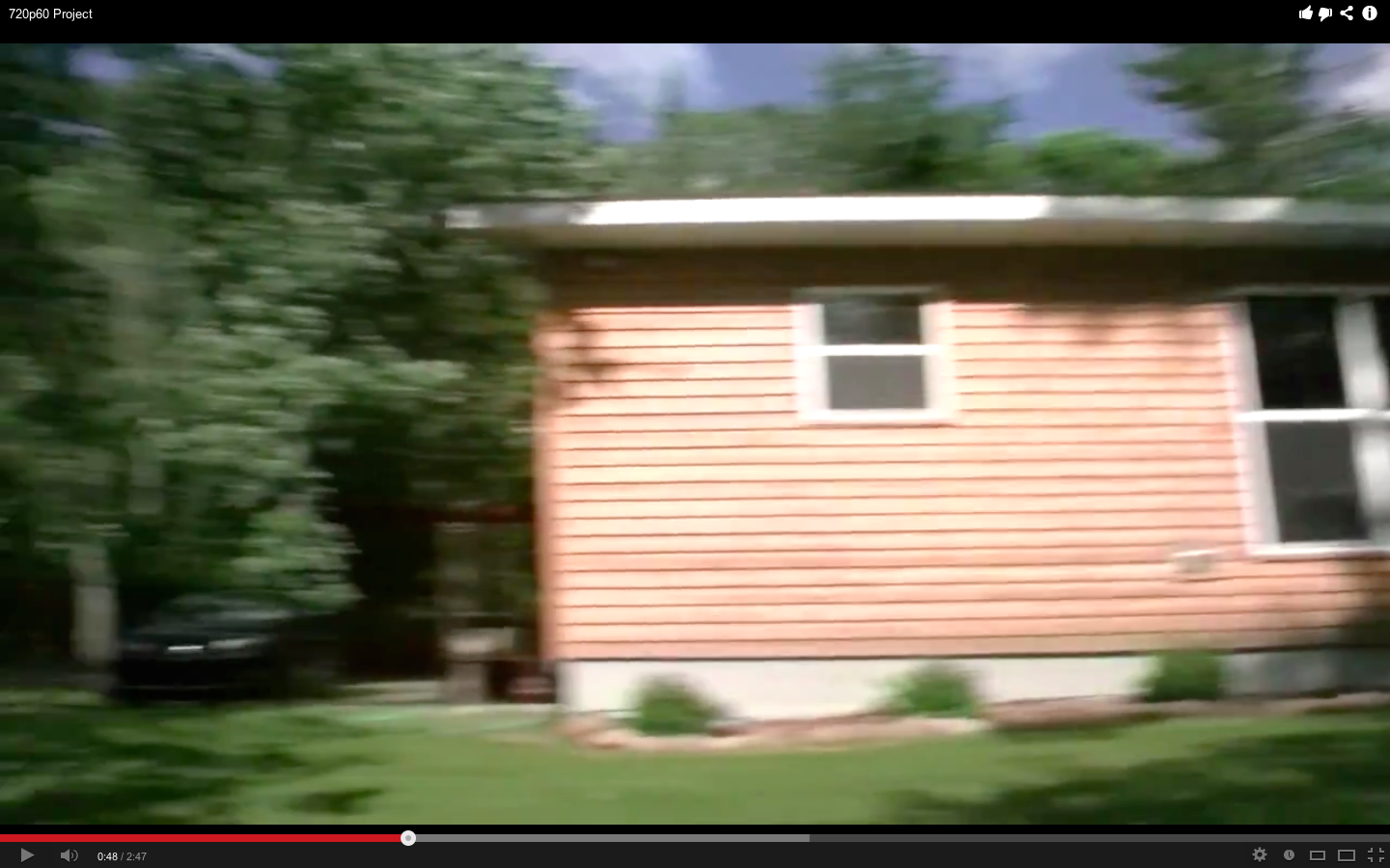

WOW AGAIN: Slo-mo can be made to look less soft. Compare this 120fps with the previous sample.
Also see:
Video gain -- AGC vs AUTO:
AGC > shutter-speed can go to 1/60th. (If already set to 1/60th, no change.) Gain is auto-added to +18dB.
AUTO > shutter-speed to 1/30th. Gain, if needed, is auto-added to +18dB.
WHIP PAN -- None, or very little Rolling Shutter in frame grab.

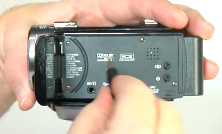

After my outdoor tests, the PX100 is a keeper -- especially now that I know how to coax much better slo-mo from it.
Will now do indoor and low-light.
And, more slo-mo and time-lapse.
Then WIFI: DOUBLE WOW.
FANTASTIC TEK:
WIFI XFER OF SD CARD CONTENTS:

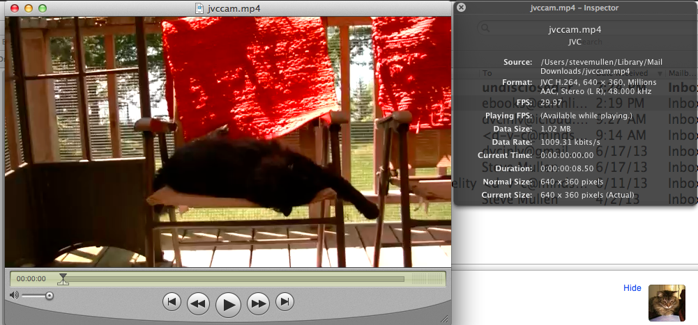

Could A/V port -- video out pin -- be LANC during recording? Bet not. But, on some JVC cameras it controls a Pan&Tilt base. Probably using audio tones.
Sent my first video mail -- anyone traveling needs this camcorder. See pix below.

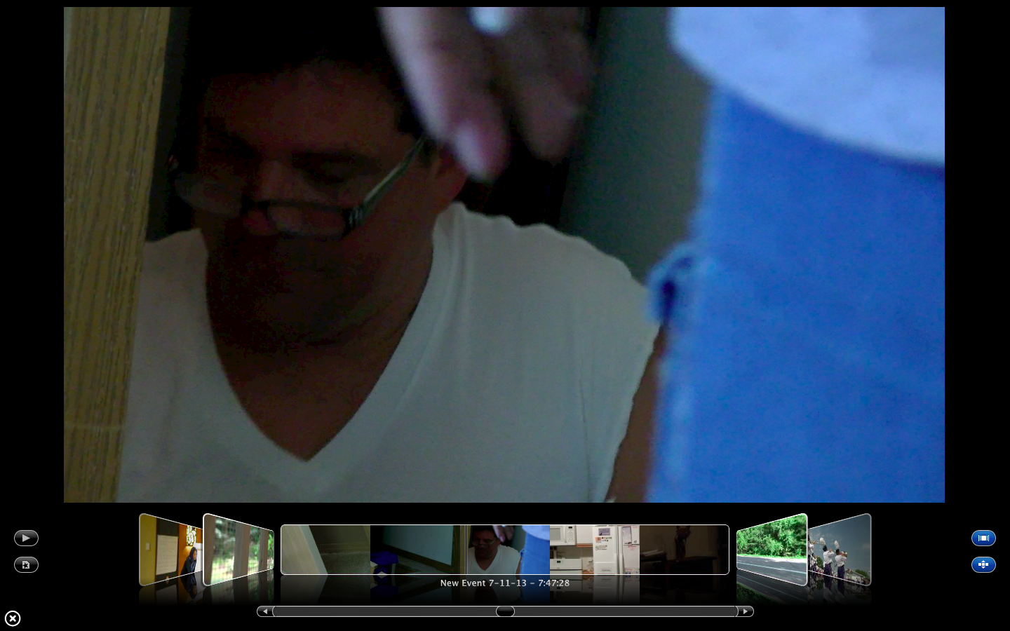

Finally my "low light" tests:
ALL SHOT AT 1/60th Second.
0dB gain, +6dB gain, +12dB gain, +18dB gain,and AGC which I assume is +24dB when at max gain.
The remaining 5 shots are AGC with 200W of light:
1) Pan in kitchen at wide.
2) CU of bottle as noise & chroma check since AGC would be at maximum.
3) Zoom out showing light gain at full Wide.
4) Zoom in showing light loss at full Tele.
5) Final kitty shot at wide.
LESSONS:
A) Do not shoot with low gain in low light.
B) Underexposed shadows have horrible noise.
C) Add light to dark shadows -- letting them go to black as one might with other cameras is not a good idea with the PX100.
D) Strangely, noise becomes lower as gain is increased to be adequate for the light level.
E) Simply always have AGC enabled. The camera will set gain to appropriate level -- nice feature.
F) Noise at +24dB is not too bad.
G) Shoot FULL wide in low-light.

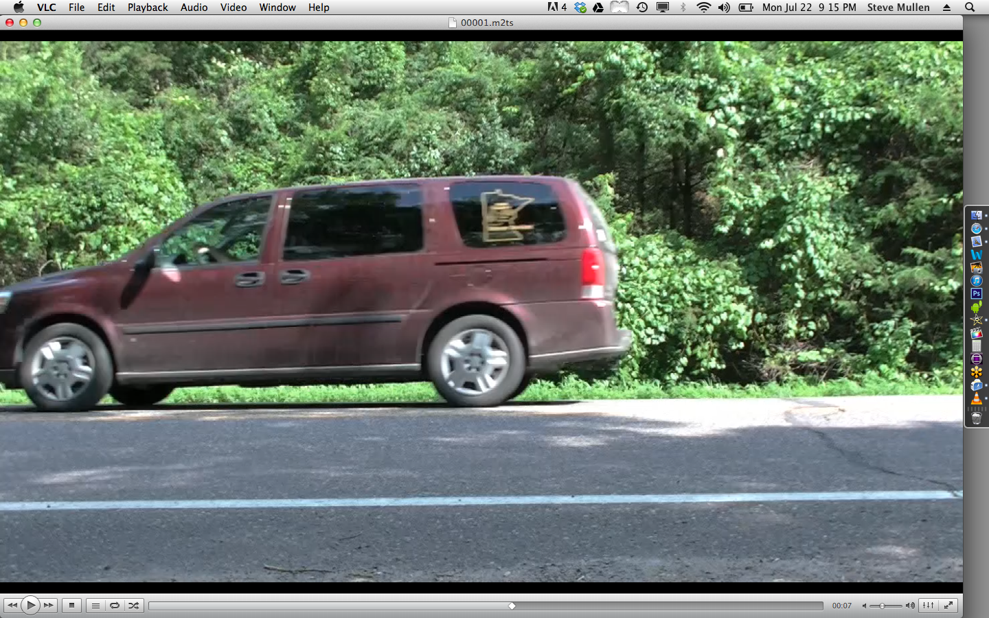

Back to 1080p60 -- An out of tune band and my `84 Bertone X1/9:
Fairly accurate, for those who live in MN, AWB skin tone.
VERY little rolling-shutter on speeding car:
