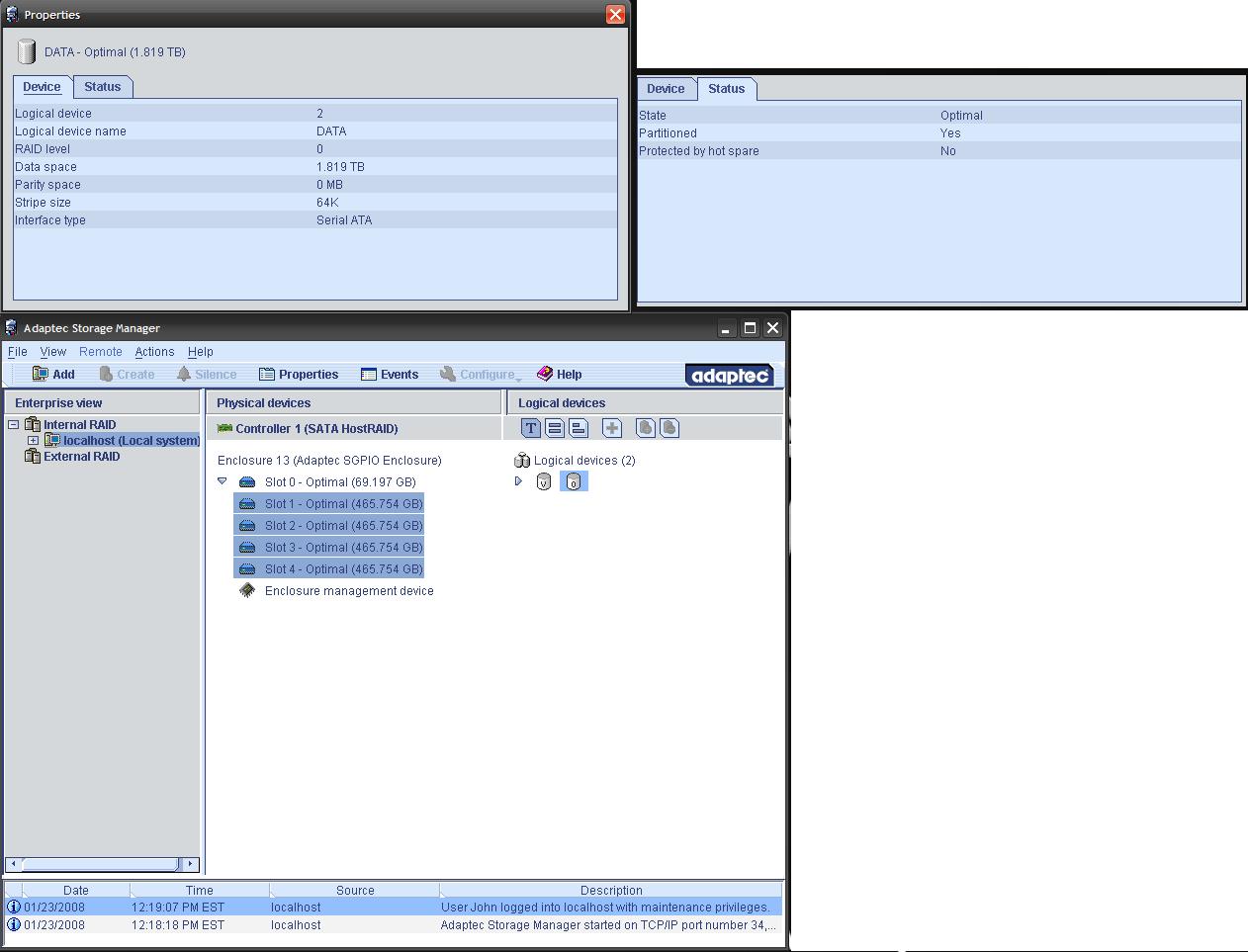

RAID was disabled in the BIOS. The technician said that one of the Blue Screens of Death could have caused it but didn't say how.
Anyway, I enabled it and changed the controller from Intel to Adaptec, as per the technician's instructions (is this a good move or bad) and the RAID appears to be working fine now.
I've attached a screenshot of the Adaptec Storage Manager in Windows and would love if you could tell me if all of the settings are correct.
ALSO: I understand that the best configuration for storage is to have Windows and CS3 installed on the System Drive and to use the RAID 0 for footage storage and creating the rendered files, yes? Is it also better to have the project file saved on the RAID or is that insignificant?
And the Media Cache Database? Where should that be? It defaults to My Documents\Adobe\Common...

Old January 23rd, 2008, 09:51 PM   #202
Location: Woodinville, WA USA
Posts: 3,467
The way you have is it to my understanding the best. Adobe has a page on this, but it depends how many drives you have. IIRC, you have the system drive and then everything else is all together in RAID 0, right?
Here's how I'm planning on setting up my new beast:
Drive 0 -- System drive with XP, CS3, Cineform, etc. Nothing not video-related.
Drive 1 + 2 (2 x 1TB in RAID 0) -- All captured Video
Drive 3 + 4 (2 x 1TB in RAID 0) -- All other assets and media cache
Drive 5 (Single 1 TB drive) -- render and preview files
This way reading and writing are mostly on different physical drives at any one time, and we'd never be trying to pull both video and audio from the same drive simultaneously. I think.
Here's the Adobe link:
http://livedocs.adobe.com/en_US/Prem...8DDE57377.html

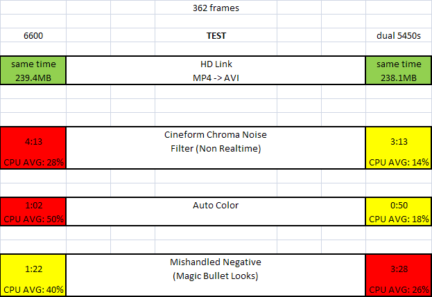

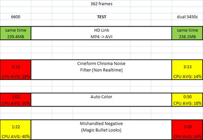

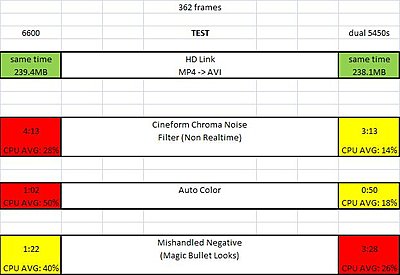

Thought I'd ask a question.
I have two computers at home, the one specified above (the 8 core Xeon) and I also have a Q6600.
To compare them it's obvious which would be the better machine:
2 x Quad Core X5450 3.00GHz
4GB RAM
2 x 7800 (one GT & one GTX) GPU
vs
Quad Core 6600 2.4GHz
2GB RAM
1 x 8600GT
I have started running both PCs simultaneously to test the speed difference in particular tasks.
CS3 loads within about 2 seconds on the 8 core, and takes about 4 on the 6600. Importing clips on the 8 core is faster, everything is pretty much. Things just happen faster. Rendering is slightly faster.
However, I thought I'd test to see where the extra money went on this super computer when it came to Magic Bullet Looks. I put a short clip (365 frames) into Magic Bullet Looks to test.
I created the exact same project on both PCs at the same time and placed the same clip in it and applied the same filters in Magic Bullet Looks. On the 8 core, it was instantly more sluggish, even just clicking on the look preset took a second or so for it to apply to the preview, whereas on the 6600 it happened instantly.
Then I clicked OK and finally pressed return to start the render.
$100 if you guess which one finished first and $1,000 if you guess the margain!
The Q6600 took 1:03 (one minute, three seconds) to finish.
It took the server, with twice the cores and twice the ram an extra 2 minutes!!!! 3:03 (three minutes, three seconds) exactly.
The computer which is supposed to be amazing was almost three times slower than the humble 6600. How the heck can this be?
Magic Bullet uses the GPU, right? And surely the 7800 is faster than the 8600, right? Everything about the 8 core PC is better and faster... except using Magic Bullet and rendering its effects...
How can this be?
I've attached the spreadsheet of my tests, including the time taken to complete renders as well as the average CPU performance.
EDIT: RE the tests, the only other thing that confused me was that the size of the AVI that HD Link created from the MP4 was different on both computers. Just over a MB larger on the 6600. Anyone know why? I definitely had the exact same conversion settings.
EDIT Vol. 2: I am also getting a large amount of "An error caused Premiere Pro to close" or whatever messages on the dual xeon machine - almost every time I use it! Could it be possible that I just need to re-install it?
Money is no object editing PC-render-test.bmp   Money is no object editing PC-render-test.jpg
John Hewat
Mammoth Media Productions
John Hewat is offline   Reply With Quote
Old January 26th, 2008, 08:01 PM   #206
Posts: 3,467
This is all very sobering.
Have you installed these?:
http://labs.adobe.com/wiki/index.php...r_Intel_SSE4.1
Old January 26th, 2008, 09:25 PM   #207
Location: Melbourne, AUSTRALIA
Posts: 735
No, I had no idea that site even existed. I'll do it now but it looks like it only improves specific things so I don't know if it will improve Magic Bullet...
Do people think it could be a graphics card issue?
John Hewat
Old January 26th, 2008, 09:29 PM   #208
Posts: 3,467
I was wondering the same thing. Also, how are your HDDs set up on your old PC?
I'd read elsewhere that dual quads were in some cases slower than older solo quads. Perhaps those plug-ins and the impending release of SP3 will improve the situation.
Old January 26th, 2008, 10:23 PM   #209
Posts: 735
Hope so. The dual quads are DEFINITELY faster than the single quad in everything other than Magic Bullet. I have no concerns about it other than that. In all other tasks it flies.
John Hewat
Old January 26th, 2008, 11:16 PM   #210
Posts: 3,467
But the crashing issue... you don't suppose the guy I referred to earlier, who posted on NewEgg that Premiere "doesn't work" on the 5450, could be right?
Adam Gold is offline   Reply
