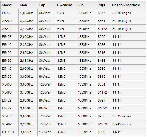

I'm getting two processors. For RAM I get 4 sticks from whatever is affordable and available and is on the approved memory list from Supermicro, whether Infineon, Apacer, Kingston or whatever. I only use XP Pro, no Vista. For NLE I use the Adobe Production Premium CS3 Suite.
I am not familiar with the Adaptec controller, but from comparison with the 2410 it looks like it is only a PCI-X card, not PCI-e and does not use a very advanced chip like the IOP341. Neither does it have cache extension capabilities. In general Adaptec is not top-of-the-bill, in price and performance.
Areca is the absolute leader in raid controllers.
Here is an overview of the new Penryn processors introduced earlier this week.
