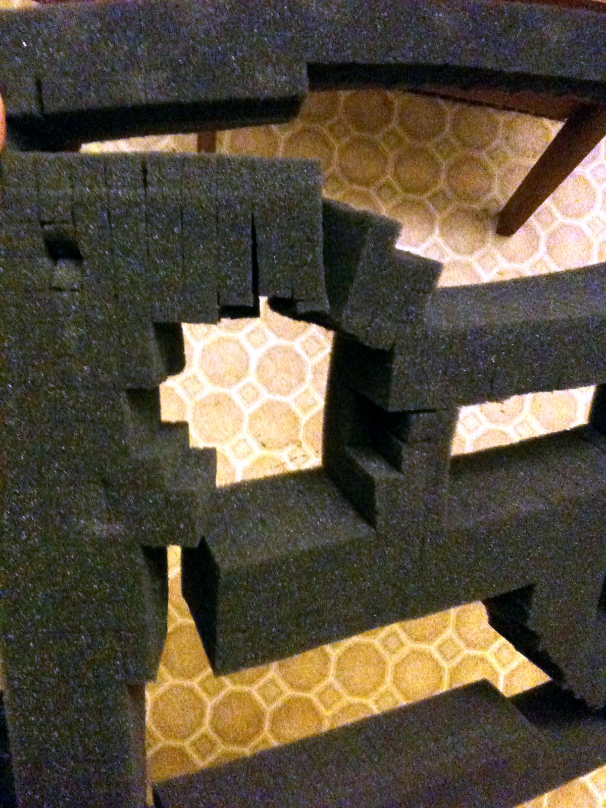

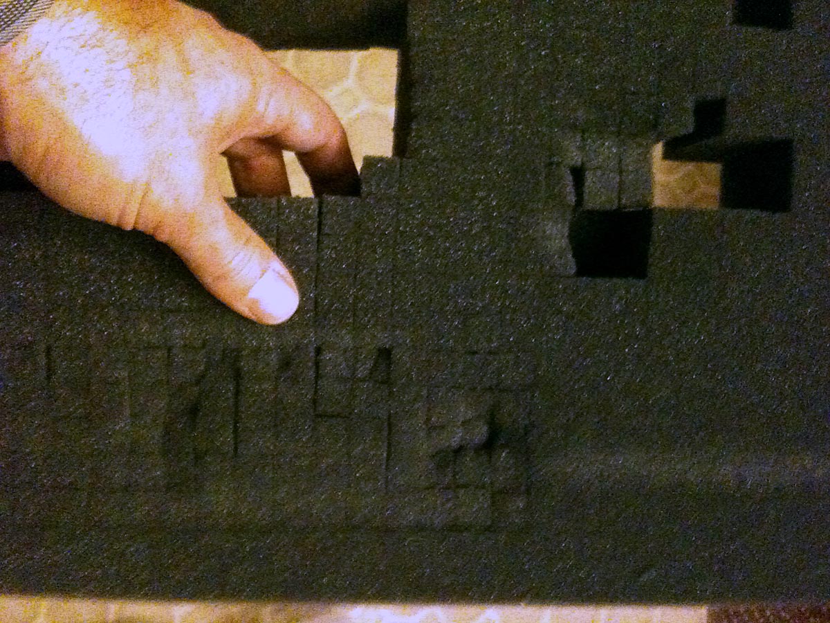

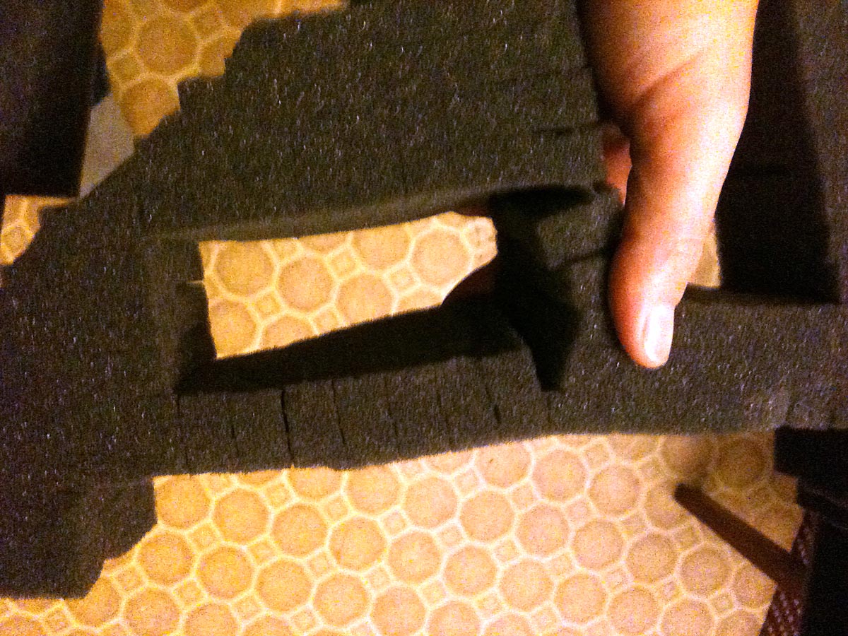

as a matter of fact, I _do_ have pictures in case you don't believe me. these pix come from my newest case, maybe 4 months old used to transport my matte box and other camera support items. mode of transport has been my van where this case has a few thousand miles on it, which is nothing.
this is the beginning stage of failure, it just gets worse from here. soon chunks of foam will start coming loose. if the foam wasn't diced, it wouldn't be coming apart, period. its intentionally designed to fail so you have to keep replacing it. I've emailed them numerous times about this, I know other people who have as well.

Are you sure that wasn't from a Bear attack? It sure looks like either that or a child under 5. :-)
Old November 4th, 2010, 02:27 PM   #5
Location: United States
Posts: 1,158
Its just had me more then upset with them. no - that was about 4-5 months of hauling the gear around. some older cases I have are even worse
