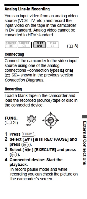

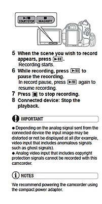

Yes - see page 71 of the User manual.

If you do it the way shown in the manual you are first recording the external analog source to MiniDV in the camera in DV mode. You then would have to capture that tape using firewire in the same manner as if you had "filmed" in DV.
The reference to USB above pertains to an external device that takes your analog video from the external source, converts it, and then sends it over to the computer using a USB connection between the device (not the HV40) and computer.
The USB connection on the HV40 is only for still images recorded on the media card.

The pass through takes the analog in from the VCR and passes it to the computer via firewire in one step. There is no need to record and then capture.

Make that a "No" then
That won't actually work on the HV-40 (just tried it). As soon as you connect a FireWire cable, the camera expects a digital input to record and the analogue input is disconnected. (Yes, I hot plugged the FireWire and the world has not ended - the FireWire input still works).
So, strictly speaking, it is not a pass through like the earlier DV cameras had. Sorry if I mislead you, but I always want a tape backup when I digitise my old analogue footage, so I hadn't noticed that until Bruce's post.

I just tried the pass through with the HV40 and it does work, but is a little tricky. I have to go to the menu and select AV>DV to ON each time I start the camera because it resets to the default OFF position.
I also found that with the software I am using (Premiere Pro CS 5.0) I had to set the device control to OFF otherwise when I hit the record button to capture it would activate the record button on the camcorder, which would reset the AV>DV to OFF again.
So, its a little tricky, but it does work with the HV40 for me.
