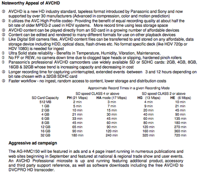

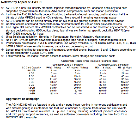

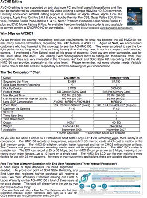

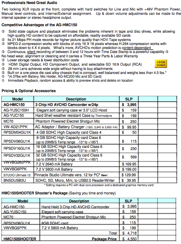

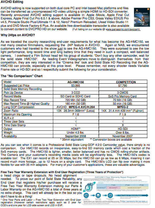

Another Update...
I've converted the .pdf file form the Panasonic Government sales rep. into a form everyone could read here. The files might take a bit to load, but say a lot about the camera...
http://i46.photobucket.com/albums/f103/KQ6WQ/Page-1.png
http://i46.photobucket.com/albums/f103/KQ6WQ/Page-2.png
http://i46.photobucket.com/albums/f103/KQ6WQ/Page-3.png
http://i46.photobucket.com/albums/f103/KQ6WQ/Page-4.png
http://i46.photobucket.com/albums/f103/KQ6WQ/Page-5.png
http://i46.photobucket.com/albums/f103/KQ6WQ/Page-6.png
Of interest:
> Pre Record, 3 seconds!!!
> The 3 User Buttons have 11 choices
> PH (21 Mbps/24 max) & HA (17 Mbps) modes use Class 4 Cards
> HG (13 Mbps) & HE (6 Mbps) use Class 2
Bob Diaz

Thanks for posting this Bob!
This camera has really caught my attention as a replacement for my PD-170/VX-2000 cameras.
