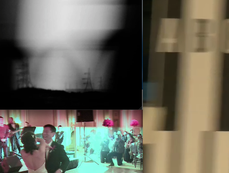

The perfect camera does NOT exist, so there's always some give and take when selecting a camera. In the case of the HMC-150 and even the HVX-200, some hate the idea of offset pixels to increase resolution. Dave is correct, if we have a green/black detail, the red and blue pixels do nothing to increase resolution.
However, if we have green/any color with a red or blue component, there is an impact from the offset pixels. Nothing is perfect here, so this is part of the give and take.
On the SONY V7, V1, and even EX-1, we have CMOS Imagers. Is this a problem, well, some hate the idea of a rolling shutter. This can cause a distortion with a whip pan. Possible, but not as noticable as when flash photos are taken, like at weddings. In the case of the CMOS chip, part of the frame sees the flash and part does not. The location is random due to the random nature of the flash.
Is this a problem? It depends who you talk to. Some find it unacceptable and others don't mind. Again part of the give and take nature of different cameras.
The Sony EX-1 is a WONDERFUL camera and it gives sharp images and good low light performance, BUT it costs a lot more than the Sony V1 or the Panasonic HMC-150. Some will argue the cost is worth it and some will say that it's outside of their reach. Again, more give and take with cameras.
If I can post the tilt caused by a rolling shutter, I will do so, if not here's the link to the image.
http://i46.photobucket.com/albums/f1...ng_Shutter.png
The Black & White shot comes from footage By Philip Bloom. The blur that tilts is a railroad car as it moves through the image. The right image was a test of a rapid pan and a test chart. The color photo of the wedding shows how a flash will partly expose part of a frame. All the shots come from the Sony EX-1.
Please don't get the wrong idea here, I'm NOT against the CMOS Chips and the rolling shutter effect. That's just the way they work. Again ... Give and Take...
With any camera there's always something. As long as a person understands the choices they will make and understand the give and take issues, they are buying a camera with a understanding of the limits of each technology. Better to understand then feel cheated.
Bob Diaz
