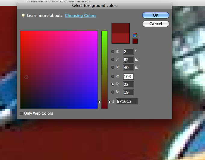

It's always fun reading your messages, like me, you have been around a few years and remember the "good old days" of 20 minute 3/4" Umatic "portable" decks that I think were around 70 or so pounds with a camera. Oh joy...
The rolling shutter issue never came up with tube cameras because the shutter was a 360 degree shutter at about 1/60th of a second. A whip pan would be mostly a blur with that long of a shutter. Camera Flashes appeared part on the first field and the rest on the second field. Plus some after image may have held for a short while.
Today's CMOS cameras, like the Sony V7, appear to have a faster speed for the rolling shutter. Thus the lean caused by a whip pan is very hard to see. However, camera flashes appear different on CMOS then from a tube camera. Flashes appear as bright horizontal strips at random points in the frame.
At this point, we are getting into a subjective area, because what bothers one person, may not bother another. To me the bright horizontal strips appear unnatural and bother me. However, because this is subjective, I understand why someone can say, "It doesn't bother me."
As far as offset pixel resolution on the HMC-150: Yes, in theory, if the color in the detail area is (0 -->100% Green AND 0% Red AND 0% Blue) OR (0% Green AND 0 --> 100% RED AND 0 --> 100% Blue), the resolution would be 960 x 540.
However, I've worked enough in Photoshop to know that this is more of an exception, than typical for images. For example, I've taken a photo I shot the other week of Motorized Scooters in a parking lot. No matter what point (color) I select in the image Red, Blue, and Green always have some component greater than 0 and changes at different locations in the image. In the photo I've attached, the Red of the Scooter also shows up as some green and blue. I've tried other colors in the image and get the same thing, at least some red, some blue, and some green.
Depending on the model one wishes to use, the increase in resolution from the 960 x 540 sensors could be form 1.2x to 1.5x. The number is debatable; however, to me the increase is enough to produce a reasonably sharp 1280x720 image.
Bob Diaz

As far as offset pixel resolution on the HMC-150: Yes, in theory, if the color in the detail area is (0 -->100% Green AND 0% Red AND 0% Blue) ..........
However, I've worked enough in Photoshop to know that this is more of an exception, than typical for images. ...... No matter what point (color) I select in the image Red, Blue, and Green always have some component greater than 0 and changes at different locations in the image.
Yes, I agree with most of that in principle. The only thing I'd add is to stress how I don't think you can have a simple number to represent resolution, it's the whole principle of mtf - how does the system deal with a change from 100% white to 0% black - how low a percentage mtf are you prepared to accept to say the system is still resolving that detail? And practically it will tail off with finer and finer detail - at what percentage do you say "that's the limiting resolution"?
And I suspect that for a given fineness of detail, the modulation factor will be a maximum if it is black-white, go down as the image becomes more coloured, and only go away in an extreme case, highly saturated colours. Hence I'd say your Photoshop observations seem to predict pixel shift nearly always having some effect on extending resolution, though unlikely to be 1.5x, certainly for any decent mtf.
Practically though, I'll agree that these chips yield a reasonably sharp 1280x720 image - it's the likelihood of any more than that I'll dispute. That's not to dispute the claims of those who say the 1080 mode of such as the HVX200 is sharper than the 720 mode - DVCProHD subsamples to 960x720 in 720p mode, 1280x1080 in 1080 mode - and I suspect what is being seen there is nothing to do with the 720/1080 factor as such, rather the 33% increase in horizontal resolution.
