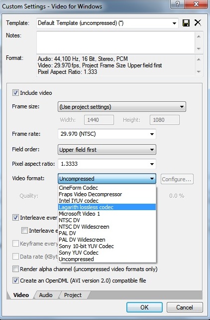

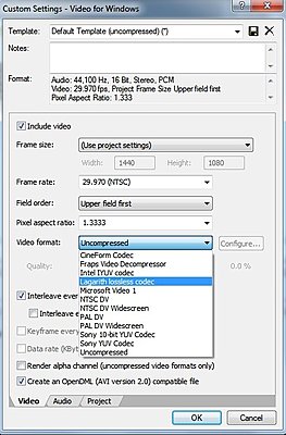

Attached is a screenshot of where I select the lagarith codec, just in case I left something out...
Also I run Win 7 64bit... and vegas 10
I would assume that you re-booted after installing, but that would be to easy haha
David

No, I hadn't rebooted, but I just did, and there it is! Do I set the Pixel Aspect Ration to 1.333 as you did in your screen shot, or leave it as square pixels? And then do I wait to deinterlace till I go into Virtual Dub?
Edit: I went back and saw you said use the same settings, so no I wouldn't interlace in first step.

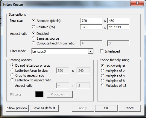

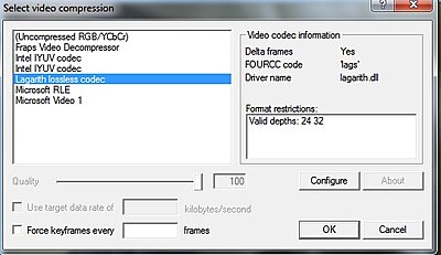

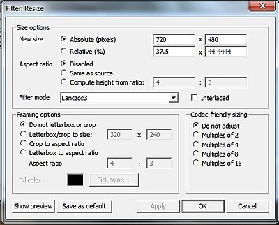

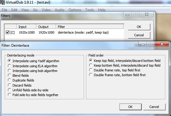

downloaded your video, and here is what I got using my method (I would use the Lagarith to render out of Vdub as well, no sense in losing any data until you have to)
then I dropped in into vegas and rendered out a Mpg2 like I was making a DVD
here is that file
http://dl.dropbox.com/u/8051517/Resized.mpg
I did de-interlace in Vdub, I think it does a good job, or at least better than vegas.
here are the settings I use in Vdub :)
David
