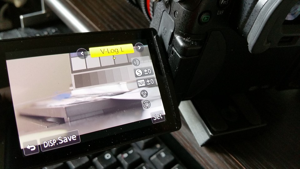

Get GH4 V-LOG for FREE !!
Someone posted this on a chinese gh4 forum.
I've already done it and it works. :)
Download the free firmware 2.3, install in camera, use the smartphone image app to change to V-Log-L.

Re: Get GH4 V-LOG for FREE !!
Originally Posted by Brian Duke View Post
Could you go through the steps of what to do in the most simple terms for us least sophisticated computer people?
Download and install the 2.3 firmware.
Start the WiFi on the GH4.
Install the Panasonic Image App on your smartphone or tablet.
Connect your smartphone or tablet to the GH4's WiFi access point.
Launch the Panasonic Image App while your camera is set to Movie Mode.
Use the Remote Control feature to access the picture profiles and set it to VLog L.
On your camera, bring up the Custom Profile screen and select Disp.Save and save it to your Custom slot.
