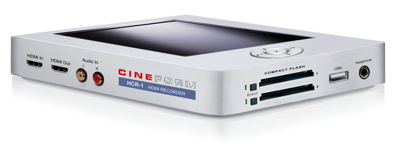

It's either wait for a Chinese P2 knockoff or wait for a portable HDMI recorder. The HDMI is also 4:2:2 color.

I was thinking, when you can potentially buy an entire device like a HDMI recorder for the cost of just a single P2 card, something is wrong.
Yes, HDMI are a consumer thing not suited for pro use in the field, hence the low prices. And if say a hdmi recorder lost power? Both expensive an propritary flash memory formats from sony and pana got features that ensure safe recording. What if you loose a clip? Often that might be more costly than one p2 card. Any hdmi recorders capable of shooting over/undercrank?
Christian Magnussen is offline   Reply With Quote
1. The designation of an an item as consumer or pro has nothing to do with price except on a marketing level.
2. If any recorder loses power during recording, recording stops.
3. Over/undercrank is in the camera, not the recording device.
