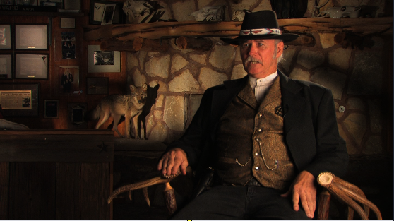

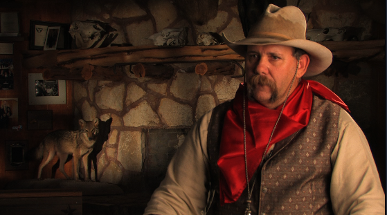

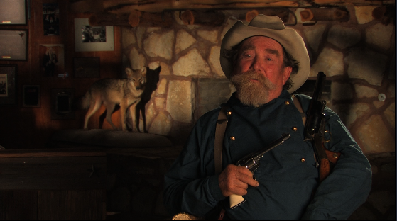

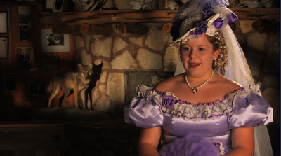

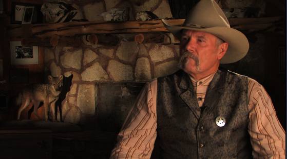

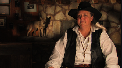

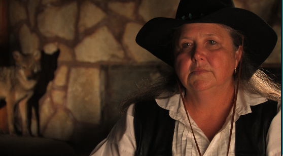

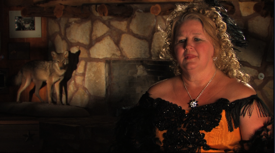

Advice Taken, see stills.
I've tried to implement all of your much appreciated advice. Please offer your critiques on the lighting in these screen grabs. I shot this yesterday for the reenactment group that my parents and siblings are involved in.
I'm revising a video I did for them, earlier this year, to tell a little more about their group.
I was able to pick up a light with a soft box for this shoot, and am very pleased with the results.
Any comments and advice are still greatly longed for. I would like to know if this quality of shot would be acceptable for a demo reel in the future, and if not, what can be done to improve.
Mike Watkins

This looks very nice indeed. Probably my only comment is that it seems customary to place the camera on the opposite side from the key light, and in this case it ssems as you've put the camera and the key on the same side. This is not to say it doesn't look good, because it does.
I might have used a bit more fill on the females but if you are trying for a consistent look, you got it. Great stuff.

Mike,
Much improved over the first shot. It's looking.
I also picked up on the camera and key being on the same side and I still have some quibbles with the background.
The shadow of the coyote tells me that the light is coming from the left, but the facial shadows tell me it is coming from the right, which I think is a bit confusing.
I think in the one close up you shared, the background is much softer and it looks better, to me at least.
The coyote shadow is a sharp high contrast element in the shot, which I think is also making it compete with the subject for your attention. I think the eye tends to go first to the area of highest contrast which means that the coyote gets more attention than I think is wanted.
I'd still suggest trying to get the perception of more separation between subject and backround either by physical distance/depth of field, or softer more diffuse and lower intensity lighting on the background.
Maybe a bit more fill on the faces would be good, but on the whole I think the facial lighting shows a vast improvement from your initial example.

You're getting there! The second picture (la.png) is starting to get the right amount of key light on the face. The others are still too dark for me, compared to the background. Couple of suggestions:
1. Don't key and back light from the same side--especially if you're not going to fill in the dark side a little. You've got both lights coming in from screen right, and no fill on the left...so it's a pretty unflattering nose shadow. As a general rule, the talent should be facing into the key. So if they are on screen right, with the open side to screen left, the key should be coming from the left side of the camera.
2. Key cool, back light warm. In this Western scenario, if all you have are incandescent (3200) fixtures, I'd do this: nice strong key with soft, but white diffusion. Backlight gets just a slight warming gel, maybe a piece of frost. The coyote/wolf gets a background light with at least a half CTO or other fairly warm/orange/straw gel on it. Be sure to white balance your camera with only the white key light, then add the other, warmer lights after the balance.
3. The other thing to consider in the background is following the shadow. You've lit the stuffed animal from the left, and gotten a really cool pattern on the stone fireplace. But notice: the snout shadow is projecting into the frame and onto the very light stonework. If you have enough room to pull that background light over to the right side of the fireplace, you can get the same patterns on the stonework, but the shadow falls away from the animal, off to the edge of the screen and into the darker part of the room, where it may disappear. A lighting purist might insist that the key and the background light appear to be from the same source...but I always check the shadows first, and see if they are leading into the frame and distracting.

Maintaining the directionalty of the shadows will help with the realism. To that end, I think the key is lighting to augment what is naturally there rather than lighting "to light". If that makes sense. If the room has a big window with nice soft light, then simply augment that rather than fight it. If you are in a room with no light, then imagine what the room would look like in nature, and build around it to create the look.
Depth of field is still a bit too much. What this seems to indicate to me is that your iris is too closed F5.6 or higher, and you really want to be working near F2 or more open for interviews. This will cause the background to soften up, and not draw attention away from your subjects.
Third, a bounce off a white card a couple of feet away would have taken a bit of the edge off and maybe softened some of the facial lines. I guess as I age, I am more sensitive to those kinds of things. And why I mentioned metering, is that you'd like the lighting in the background to fall off a bit. The coyote is as bright as the actors in the scene. Put enough light to suggest what it is, but not enough to make us stare at it.
One thing that strikes me in this is the framing. It's VERY good. Headroom is excellent. Laying the subjects on thirds is very good too. I might offer that if this is going to go into a longer piece, that you not place everyone in exactly the same place. Meaning that if you have 8 interviews and they are all in the same room, that you shift the background so that it doesn't look like you shot it on an assembly line. Moving the camera 5 feet left or right should do enough.
But again, this is 100% improvement over the first stuff, and now we're nitpicking. :)

You are back to your old tricks again.
The background is competing for attention, is too bright, too much in focus and too close to the subject. Back off you subject from the background by a lot. Place the camera in the next room if you have to and shoot thru the doorway. This problem of too much depth is worse on smaller chips camera such as the 1/3 chips, you really have to compensate by creating more distance. By increasing the distance of the different planes in the image you will also minimize the effect of light spills.
You still have the key and the background light coming from different directions, you always must give the illusion that there’s only one main light source. Also soften the background light when you have something casting shadows.
Placing the key light on the broad side of the face will work in some occasions but not with ladies, particularly not with overweight ladies. As you can see it’s not too offensive on the men. Again, the psychology of lighting will attract and make stand out the lighter portions of the image, we want to viewer’s attention to fall on the eyes and mouth, this are the area that the key light should be concentrated. Cheeks, ears and chins are not important, Place the key light on the short side of the face, that’s the side facing away from the camera; easy to remember, the side where the camera can’t see the ear.
Raise your key light; the cheeks are casting shadows below the eyes, that’s a no-no. This technique is called theatrical light; this is when you want to make someone look sinister. See the basic light positions below; remember that the best way to see if the light is well positioned is by studying the shadow it casts and particularly the shadow on the side of the nose. See the attached images.
Raise you camera, you are way too low, you are shooting up the nostrils. The starting rule should be that the camera lens should be at the subject eye level, you will then have to tilt down to frame it. For overweight people even higher is better. First you will not shoot into their double chin, second a higher camera angle will force the subject to raise her head, this will stretch the extra skin below the chin and make any double chin disappear or make it unnoticeable. Try it at home in front of a mirror.
When a person wears a hat you might have to use a different lighting technique, use a 90 degree light, only half of the face should be lit and no light at all on the shadow side of the face. Keep the key light at low height so the visor will not cast a shadow on the eyes, but be careful, don’t place the light below the face or you’ll end up with the sinister look. Compensate the shadow area with a good and soft fill. See the second pix of coach Gruden below.
