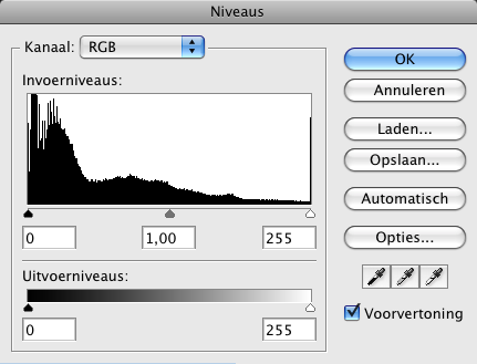

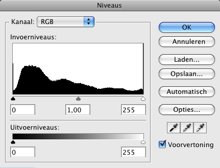

Originally Posted by Mike Watkins View Post
This is just a set up involving my wife, who is sick of me
Hi Mike,
For me the forground is too dark whilst the background is light(er) which is "the wrong way around". My suggestions would be to increase the light levels for the foreground and to seperate your wife from the seat more by adding more light on her right shoulder.
I've doctored your image a bit, redistributing the shadows, and the skintones aren't perfect but you can tell the key was a bit hard. Disregarding the wall the rest of the image gained color and detail and your wife is now more 'in the foreground'. It is probably not 'the look' you were aiming for, but just me (trying) to make a point.
I have no problem with a contrasty background; as long as the subject is seperated properly that is where you'll focus.
