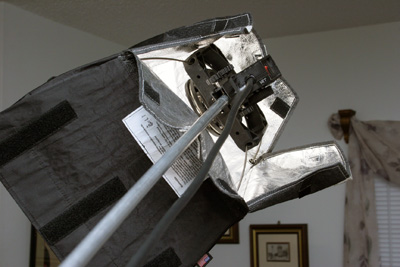

Originally Posted by Nino Giannotti View Post
one small 250w Lowel Pro light mounted on a XXsmall soft box
Is this the Chimera XX-Small video soft box?
http://www.bhphotovideo.com/c/produc...ro_Plus_1.html
What speed ring do you use for this?
Thank you!
Old July 23rd, 2008, 08:06 PM   #33
Location: Tampa-Orlando, FL
Posts: 124
Thank you!
That's the one. Lowel also make a speed ring that goes for about $40.
I use this light mostly in my travel kit so everything has to be lightweight. Instead of a boom or gobo arm I use a 1/2"x3' aluminum tubing available at any home improvement store and a standard grip head.

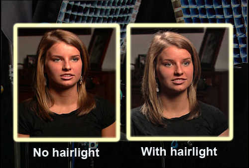

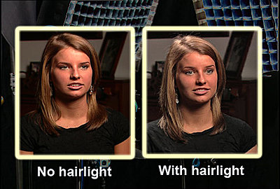

I can still see the inside her nostrils, raise the camera more. Also raise your key, everything in the face is flat, shadows are just as important as the light; you need to see the separation between chin and neck. See the demo below and look at the shadow below the nose and below the chin. If you feel that the shadows are too prominent then use a small fill light.
If you are going to use front key instead of 45 then move it in front, the in-between little shadow on the side of the nose is not very flattering, also see the sample below. If you do this in most cases you will not need a fill, looks like you are using a side reflector, place the key properly and you will not need one.
Start using a back or hair light above the subject, this will give you separation without having to worry too much about the background light. Again see sample below.
The correct position for the backlight should be apx. 4' above and at a 45 degree angle behind, pointed toward the back of the head and placed directly in the back center opposite from the direction of where the subject is looking to.

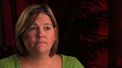

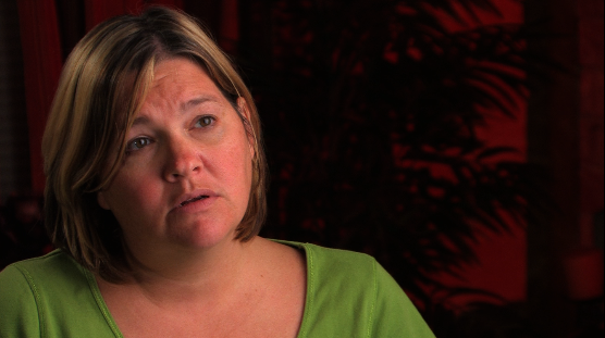

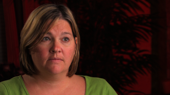

I feel like I'm getting closer on the interview set ups. I'd appreciate some feedback on the footage I'm linking to.
Mike Watkins
30 second teaser for dvinfo.net documentary contest
Mike Watkins is offline   Reply With Quote
Old October 21st, 2008, 09:50 PM   #42
Location: Tallahassee, FL
Posts: 4,100
Very nice Mike! Looks like you've learned. Only two small criticisms is one of the interviewees is still a bit close to a wall with no breakup, and the last person seemed to have a bit of a hotspot on them.
But looks good!

Again, watch your background, viewers will see bad composition before they see bad lighting. Your lighting is good, keep making small adjustments as you go along but look at those backgrounds.
The first shot of the boy, good lighting but there's something that looks like a cable TV box growing out of his face.
Second shot of the man in front a dark background, don't change a thing, that's the best of the bunch.
Third of the woman, I believe that's your wife? First avoid vertical lines splitting the image, there are two different pictures into one. Don't paste your subject against the background put as much distance as you can, unless for some reason the background is part of the story. Probably you are using a small 1/3 chip camera and with those you'll have difficulties reducing the depth of field in order to create good separation, use distance and darker background to give the illusion of depth.
Same for the last shot, too close to the background and same light value. Just like the shot above the background is competing with the subject. Also when you have something like a picture frame in the image make sure it's not crooked, in this case probably your camera wasn't leveled.
Your lighting is good, just fine tune it and don't go crazy yet it will get better with time and experience, work on the rest of the composition, that's more important.
