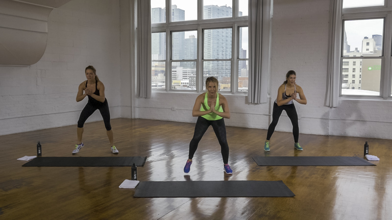

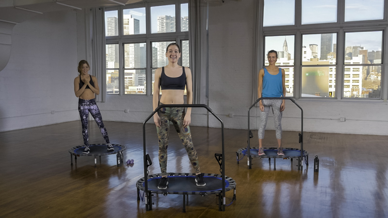

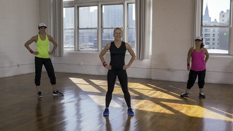

Hey all, sorry for not following up sooner, was waiting for the client to post some of the finals (i'm not the editor on the project), but until then...
To sum the shoot up: the client was happy.
But of course i'll elaborate:
Settled on half soft frost, which kept just enough punch to squeeze almost everything into serviceable place on the waveform, but required plenty of tweaking along the way to accommodate changing light as well as various moving/non moving talent, which ranged from mostly stationary, to jumping up and down, to all over the place. I would have liked a chunk more setup time to really squeeze the most out of the setup/gear, but that is par for the course.
Suffice it to say the challenge of creating a wide enough field of light with minimal diffusion was the greatest battle. As the days got late, the sun did make its appearance, which we all loved the look of except for the last shoot on day 1 where near the end it got a bit too "stylized", but still the client was pleased.
The client has done several shoots before, so it seems she has a good handle on budget vs tradeoffs, vs expectation, and all such things i conveyed to her along the way. Such as when finalizing the first setup she asked about the shadows; i advised i could reduce/remove them but at the expense of the window exposure. She of course chose windows over shadows. If it weren't for a pillar in the middle of the space, i could have pulled everything back and gotten the shadows all on the floor.
The attached grabs are from the GH4(the wide shot), and a quick dirty grade done in cameraraw.
