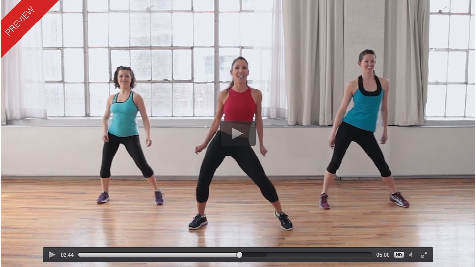

Here's a shot from one of their prior videos, and from what i'm told, they used 4x 4 bank kinos + 2x 2bank kinos. I am not aware if they were expecting to compete with the windows with that.
