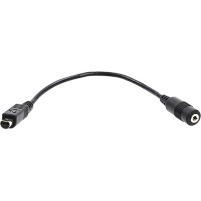

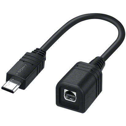

Originally Posted by Ron Evans View Post
Sony make a whole range of tripods with remotes and also separate remote controllers.
Ron Evans
The problem is I haven't seen any remotes that will connect directly to this camera without an adapter. The only adapter I have found is for the D-type remote plug. To use a 2.5mm remote plug, I'd have to go through two adapters or make my own. Sony put their new multi connector port on this camera. I'd like to just use my Canon ZR-2000 with this camera so I don't need to swap out remotes when going from one camera to another. I think the Canon and Sony Lanc protocols are the same, except for certain functions I can do with the Canon won't work on the Sony, just the basic start/stop, zoom and focus is what I'd expect to work.
Mark
Sony FDR-AX100-sony-vmc-avm1-lanc-adapter.jpg   Sony FDR-AX100-fdr-ax100-multi-port.jpg
Old May 11th, 2014, 04:07 PM   #1176
Location: Apple Valley CA
Posts: 4,874
Re: Sony FDR-AX100
Mark -
You're probably barking up the right tree with having to use two adapters... I have been trying to figure out an adapter for the RX10 (Cybershots don't use the same configuration on the MULTI plug evidently, dang it!). The VPR1 remote (that plugs in and works with the RX) uses the same chip as an RMAV2, yet the adapter A/V to MULTI doesn't work on the RX series (!?!?!?!). BUT to be fair, the AVM1 only lists HANDYCAMS in compatibility, not Cybershots.... sigh.
I'm sure there's a "hack", but haven't had time to completely reverse engineer the cables and circuitry - I did find some stuff on German boards with pinouts and such for the MULTI, but not enough to figure out the key to unlocking it on the RX series!
I'll have an AX100 shortly, and have both the adapters, I'll see if I've got any "different" LANCs to try variable speed. I would "suspect" that they should work, but as you state, LANC protocol implementation varies WIDELY. Typical Sony remotes have start/stop, on/off, photo, and 2 step zoom, other functions that other brand remotes might offer are "hit or miss".
Probably the cheapest option is an RMAV2 and the AVM1, I'm hoping to find THAT combo works, as I have all the bits for it already!

I have this Sony http://www.bhphotovideo.com/c/product/913260-REG/sony_vctvpr100_highend_remote_tripod.html as one of my tripods and it comes with 4 different cables to meet all the Sony connections. I also have a few smaller Sony tripods that I just took the handles off and modified to fit my Manfrottos tripods. All have controls for start/stop, variable zoom ( works with my SR11, XR500, CX700, NX30U and NX5U ), markers, photos and on/off. I would be surprised if the AX100 did not have variable zoom as even the still Sony HX30V has variable zoom. The on camera zoom controls can be very sensitive though. I also have a Manfrotto controller for my NX5U and a Libec with a converter cable for the NX30U. All seem to work fine.
That's what I found out. Having my Cybershot HX400V ready on the tripod, plugging in this Sony's own Multi-to-D Shaped AV adapter into the camera's Multi port on one end and my old Handycam remote on the other and then voila! nothing happened. ALL controls on the remote were as dead as a piece of plastic. So as Dave says, when Sony say Handycam or Cybershot or Alpha, they really mean it.

The strange thing is you'd THINK the MULTI interface would be compatible, but somehow it is implemented differently - the AV2 LED lights up, so there's power to the LANC interface, but somehow the camera is not being told to accept the commands. I've seen this before when the 2.5mm plug was replaced with the LANC integrated into the A/V jack/plug... so I do think it can be hacked so most any LANC could be used with Cybershot, just a matter of figuring out how the VPR remotes do it, since they seem to be able to work on all the Sony lines...
