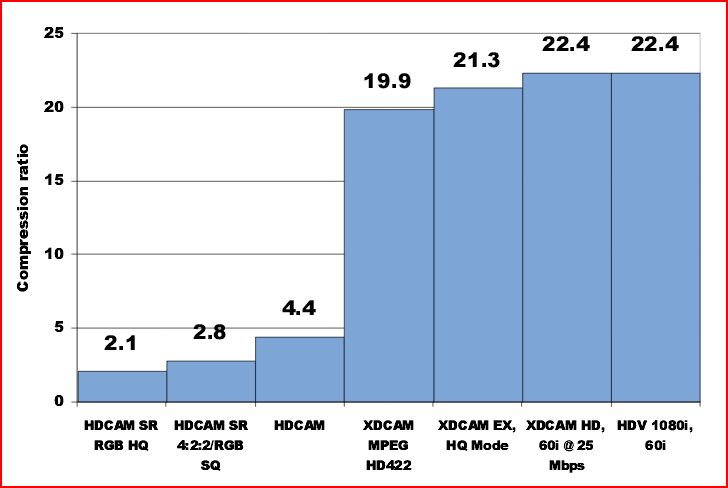

Old July 23rd, 2015, 08:44 PM   #125
Location: Sydney Australia
Posts: 1,622
Re: Sony X70 4K - Lowest bit rate in the industry!
Originally Posted by Cliff Totten View Post
So with that being said,...more image data is being dis-guarded in 60Mbp/s than it is in 100Mbp/s. The compression ratio is significantly higher in 60Mbp/s.
This compression vs bit rate argument has been around for a long time and was discussed to death many times in the early days of XDCam 35-mbit vs 50-mbit yet their corresponding compression ratios were very much the same. As Jody says "How does it look." If it holds up in post and especially if transferred to a higher level codec and works in the real world and everybody is happy with the result that should be the final arbiter.
I've shot countless hours of broadcast on both the 50-mbit and 35-mbit XDCam flavors and never had an issue with networks here and overseas and subjectively it's it very hard to tell the difference in the picture quality given that both come of correctly set up cameras. I've lost count of the number of hours we have shot in 35-mbit that has been rendered to 50-mbit for delivery to TV and never once had a query on quality.
As Alistair quoted way back in 2009:
"4:2:2 = (1920×1080 + 960×1080 + 960×1080) x30(fps) x8 (bits) = 995Mb/s. Divide by 19.9 and we get 50Mb/s
4:2:0 = (1920×1080 + 960×1080) x30(fps) x8(bit) = 746Mb/s. Divide by 21.3 and we get 35Mb/s
So from this we see that the compression ratio for EX is 21:1 and for XDCAM HD 422 20:1. This is extremely close and in terms of compression artifacts means there will be little, if any, difference between the two."
HD Warrior » Blog Archiv » XDCAM 422 v XDCAM EX by Alister Chapman
In the real world I have found this to be pretty true so we can't judge everything on bit rate and compression ratios alone.
It is also well know that Sony have their own proprietary compression algorithms that comply with the H.624 standards. Therefore we are only surmising when we say there must be a difference between the 60 and 100-mbit bit rates re artifacts when we don't know whether Sony is using a different proprietary algorithm for the the bit rate compression between the AX100 vs the X70. On that basis alone it makes it almost impossible to come up with an objective assessment of the differences between the two bit rates.
I've long ago given up nit-picking with the numbers. If it was all based on numbers then the Go-Pro would never have had a look in in the broadcast world yet they are everywhere like a plague. As Jody says if it looks good, feels good and works okay for the project you are working on run with it.
Chris Young
CYV Productions
Sydney
I agree with everything you say here Chris. I'm not going to name names here but...the media company that I work for setup an HD deliverables standard for "Gold", "Silver" and "Bronz". Sony was very unhappy with where we placed 35Mbp/s XDCAM EX and really wanted us to change our standard. We didn't. At a SMPTE meeting in our office, Sony sent their CTO (I wont type his name but he was EXCELLENT btw) and even he tried to pitch XDCAM 4:2:2 and EX to the group. He even brought monitors and gear with him on his demo. He showed us phase-inverted-canceled A&B shots to inspect artifacts....really cool stuff! In the end, we still didn't elevate XDCAM EX on our standard (because of the "numbers") and I think Sony was really upset by that.
Meanwhile, I know for a fact that we were airing a major show with boats and drama on the water that was shot mostly on HDV (25Mbp/s 1440x1080, non-square pixel) tape at that time. (go figure?) Ehh,...maybe I have said too much already ;-)
Anyhoo....I agree with you on your post Chris.
The maths is correct as far as it goes, but I'm afraid the reasoning is wrong on several levels.
Most importantly, you don't need twice the bitrate to code 4:2:2 chroma as you do 4:2:0. The reasoning is similar to why when you compress still images, for a given quality level the file sizes don't scale linearly with image size. If you've got a 4:2:0 chroma image, you can effectively "guess" at in between values. ("Guessed" 4:2:2.) So to code the true 4:2:2, you only need the values of how different the true values are from the guesses. Which can be represented by a lot less data than the original 4:2:0 chroma signal.
Secondly, Alister assumes the same compression ratio for luminance and chrominance, and for MPEG2 this is not necessarily true. It's frequently the case that the chroma signals get far harder compression than luminance - this is why when banding may sometimes be seen (esp on digital broadcast TV), it's frequently most noticeable on areas of plain saturated colour, more rarely on more monochrome scenes.
So you can't do a simple sum of total numbers of chroma and luma pixels, compared with total bitrate and reach any meaningful simple conclusion. It's far more complex than that.
