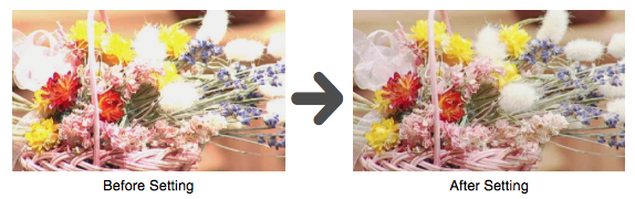

I was reviewing some old Sony guides and found this interesting chart. For anyone new to this stuff it does a good job of visually explaining Point and Slope. It shows how Slope controls the exposure rolloff of highlights and how lower and higher Point values move the starting point of that rolloff left or right. It also shows that + values for Slope create a more gradual curve - which is different from the X70 manual! The X70 manual says the opposite: minus values are gentler and plus values are steeper. So is that different for the X70 or a mistake in the manual? Regardless, I'm finding that if I raise Slope to +2 or so it allows me to set the Point a lot lower before the weird posterization sets in. This idea may be total garbage, but it's at least another direction to experiment with.
I'll also post the example photos from Sony that show what the custom Knee settings are supposed to be able to accomplish.
