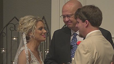

Last couple of weddings I have noticed the X70 not handling skin tones very well. Some skin will look blotchy red and sometimes bluish purple. I have attached a screenshot showing the problem.
Can this be corrected with picture profiles?
I was using about 9db of gain with WB at 3200K
You can see on the grooms cheek and ear and also around the pastors mouth the purple tint.

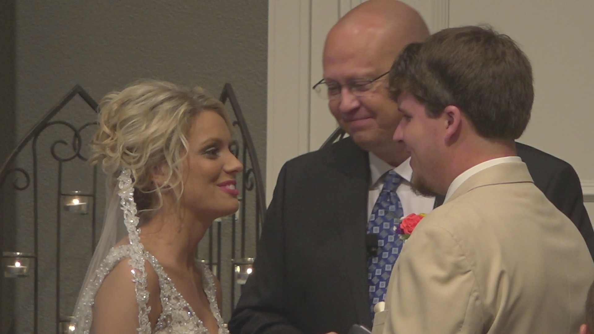

Just for comparison I attached the XA20 shot.
Here's the profile I'm using.
Black Level - +15
Gamma - ITU709
Black Gamma - Range High - Level 7
Knee - manual - 82.5% - Slope +1
Color mode - ITU709 Matrix
Saturation - -1
Color Phase - -1
Color Depth - All 0
Color Correction - Revision - Memoty 1&2
Memory 1 Color - Phase 10 - Range 4
Memory 1 Revision - Phase +8
Memory 2 Phase 19 - Range 7
Memory 2 Revision Phase -14
Detail - -2
Manual Set - On
Limit - 7
Crispening - 3

Does the camera have a standard profile that doesn't change anything? I never was a big fan of making adjustments in profiles as they often introduce more problems then they fix if you don't exactly know what each setting does.
I would test to see if a "no profile" has the problem as well or not, if that is not the case then a wrong setting in the profiles is the cause but don't ask me what that would be.

The PP color correction settings I posted in the old post were specifically meant to address the two most offending colors. You can only select two colors on the vector wheel to adjust, and I chose to first align RED, and then GREEN. Red effects your SKIN TONES, so that is the first priority. Green is on the scope the furthest off, extending almost over to where yellow resides.
The best we can hope for with color correction settings is to reduce the variances of two primary colors at once. This makes further correction in POST easier, because you have the camera as accurate for as many colors as you can get it when recording to file.
QUESTION........were you on a preset or manual kelvin, or did you PUSH TO WHITE on A or B? I ask because the X70 has a tendency to move the color wheel all over the scope when you push to white. If you white of anything slightly lit with an LED or florescent, then the entire color spectrum will SHIFT towards MAGENTA to counteract the slight green in those push to white sources. Redish skin tone would be indicative of a magenta shift.
And another tip. please consider the PHASE adjustment something you can feel free to mess with DURING A SHOOT. If you see reds especially that look a bit off, just tweak that PHASE adjustment left and right until you are happy with the results. I shoot a lot of fire trucks, and it is almost impossible to get them to not be ORANGE or PINK, even with my color corrections. Simply messing with the PHASE can make them happy "fire engine red", but you don't want to live with that specific phase fix all the time.

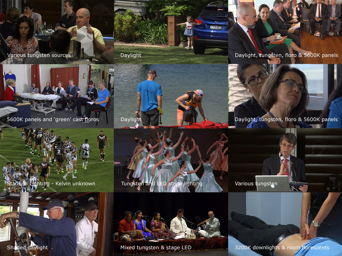

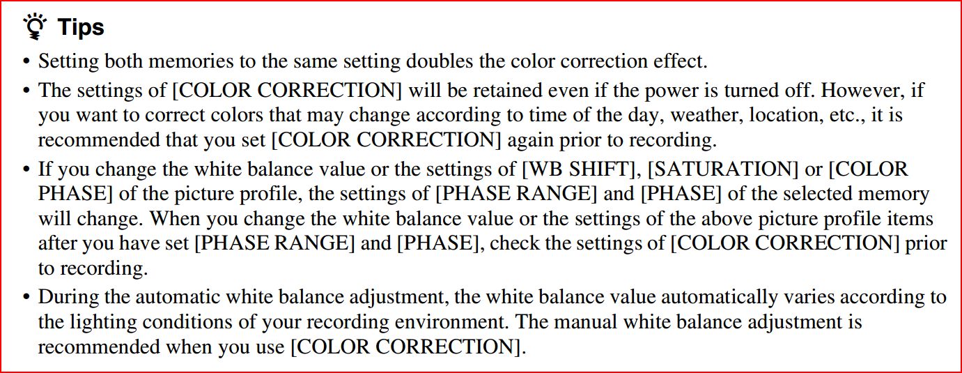

I would 100% endorse this quote of Noah's. The minute you start playing with the color correction in the x70 it can cause problems if you change lighting, white balances, locations etc. If you are working under a controlled fixed lighting setup in one location then I find the CC adjustments great to fine tune one or two particular colors in the scene. The minute you change any of the lighting parameters / temperatures these settings go west. The x70 manual is quite specific in warning users about this on page #58. Paying particular attention to the third bullet point. See attached page grab.
I can only attest to my experience with the x70 but in all the cases where I have used this camera with the settings I favor I do a manual white balance. if that is slightly off when I come to post color correction at least it stays consistent and is easy to fix. Trying to CC an auto track white balance in varying conditions is enough to send me to the funny farm very quickly.
I've attached a compile pic showing skin tones. Each one of the grabs represented are straight off the camera files without any correction applied. Each setup was with a manual white balance at the time of the shoot and using my own PP4 settings. I'm not saying my setup will appeal to anyone but what I am trying to point out is that in a multitude of very mixed lighting scenarios I have not seen any really offensive off color issues with regards to skin tones when NOT using the color correction settings.
When using modified CC settings I have found I HAVE TO re-adjust those CC settings if I do a white balance otherwise the adjusted colors can influence any tones in the picture that have any component percentage of the adjusted colors in them. Adjusting the CC settings and running auto white for me is walking on the wild side. Quite unpredictable in what the resulting images will look like. My two cents.

Roger that Chris. My PP color corrections were done with Lowel Omni lighting at 3200k, which is why I insist they are best used with MANUAL KELVIN matching your lighting. I would rather move the FCPX global hockey puck up or down a bit to correct for LED type lighting than let the X70 push to white move that variable in any direction it deems workable! Easier to correct for a lighting variable that to correct for a push to white all over the scope.

Noa - I think I might go back to the stadard profile, I didn't see this problem on the first few weddings I shot with the 70.
Paul - I was on the 3200 preset. I tried push to white first which gave me 3000k but I liked 3200 better.
Chris - All the skin tones look very good in your screen crabs, I would be very pleased with that.

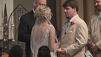

Most of the time skin looks good, it's when the skin has two shades to it, that's when the x70 seems to magnify the red in the skin. The brides face with all the makup on is nice and even so no problems.
Last weeks wedding the back of the brides arm would always look sunburned red, they might have put makeup on the front, don't know. And you can't see this on the cameras flip out screen. I even went back and looked at that shot I attached and it looks fine on the cameras screen.
I'm finding that I also prefer manual WB. I often do the same with my DSLR.
Along with manual WB, what PP do you tend to use most Chris? For now, I'm just using unmodified (i.e. factory settings) PPs. Still not set on which one I like best, but have been experimenting mostly with 3 and 4, but a couple times with 5.
